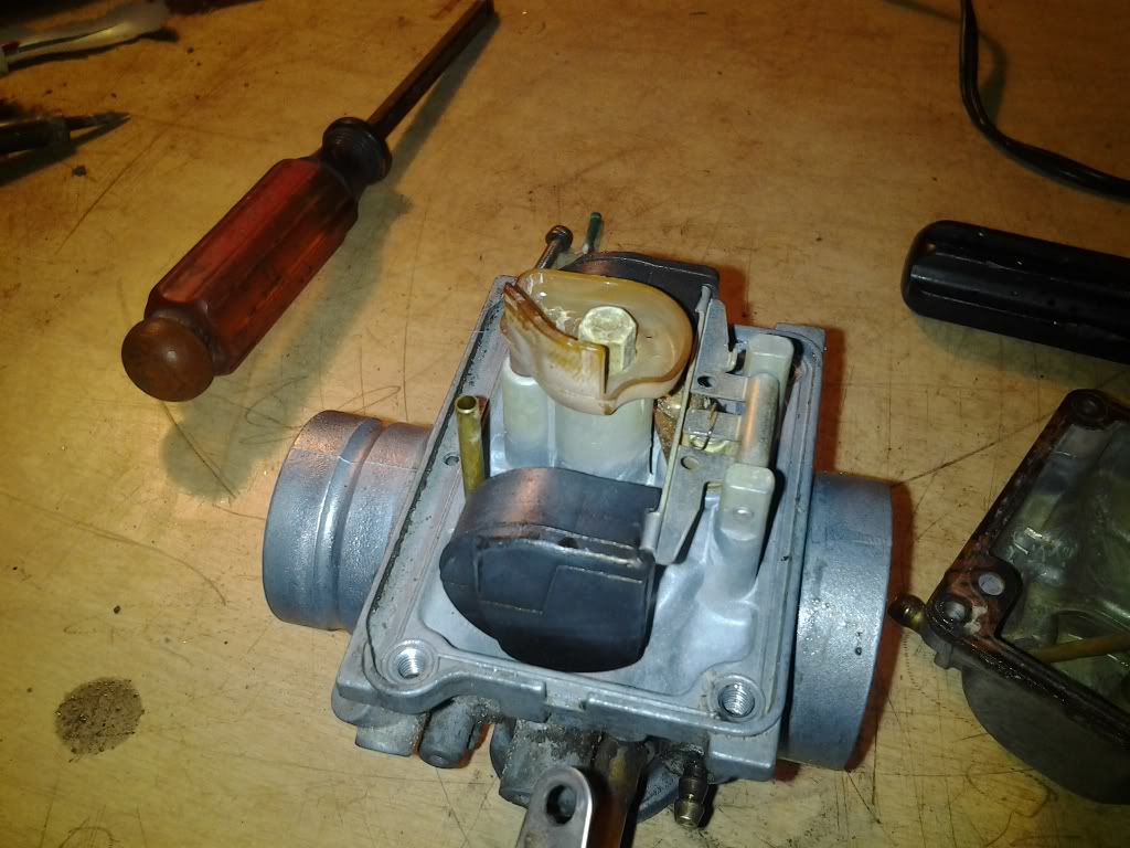

B BGmins New Member Jul 21, 2012 32 0 6 Texas Jul 21, 2012 #1 The little tube. And i think im running lean cause po put a fatty pipe on and i think i still have the stock jet. Its a 230.
mjgnslngr New Member Dec 11, 2011 1,702 25 0 Vermont www.facebook.com Jul 21, 2012 #2 Vent. And you need at least a 270-280 main. With the fmf and no airbox lid.
89blaster89 Member Aug 26, 2011 4,739 26 90 29 Pacific northwest, washington Jul 21, 2012 #3 clean that carb and im at 290 with my mods
B BGmins New Member Jul 21, 2012 32 0 6 Texas Jul 21, 2012 #5 When you tip the carb, fuel comes out those vents through two holes on the cieling. If you know what i mean. This vent im having trouble with, air only blows through when the choke is half on or on. But with the choke off it doesnt go through.
B BGmins New Member Jul 21, 2012 32 0 6 Texas Jul 21, 2012 #6 Im about to answer my own question. That little tube is for the choke thats why it works how i described in the last post. Which means i got other problems.
