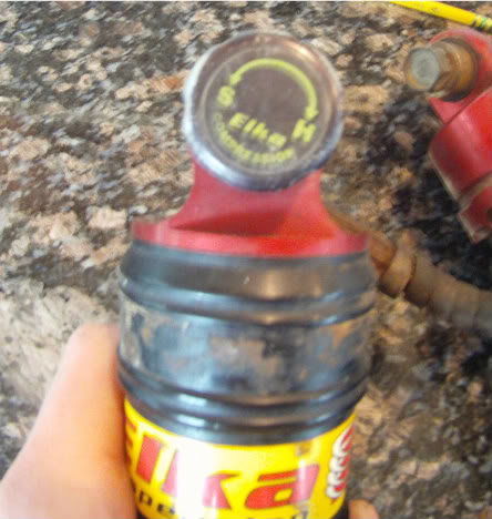

Couple questions, what stage elkas are these? They look like stage four because of the remote rezzy's but I am not sure. And would this elka rear shock be better then a Works 400ex rear shock? Thanks!
Also what does this do?
also good to know here too, as the rear elka i just scored has the rebound screw adjuster !!!!!!
show a pic of the adjuster on the bottem of the rear and that dosent mean that the fronts are stage 3 just cuz the rear is
