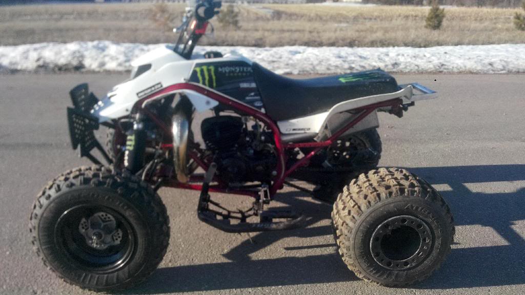

I run a trinity right bend with aggressive porting and a larger carb.
A stock motor would run well with a right bend but porting and high compression would be a great idea but are not needed to run one.
They sound great and pull forever!!!
IMO they are the best pipe you can get

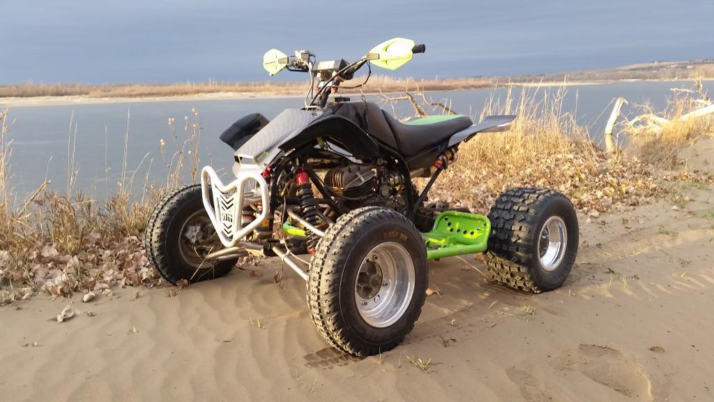

I Just put a right bend on my stock motor and i love it, a right bend wont disappoint you.
I also had a toomey pipe and silencer on an 03 blaster stock motor a few years ago that i was also very happy with, the toomey seemed to me like it had more mid range than my right bend but the right bend has a better top end and just keeps pulling.
What are you talking about when you say right bend
The expansion chamber is on the right side unlike the stock or some aftermarket pipes that start on the left side and come over the top of the motor so to say and back to the right. a right bend expansion chamber is all on the right side. Right bend pipes seem to favor the upper rpm range.
