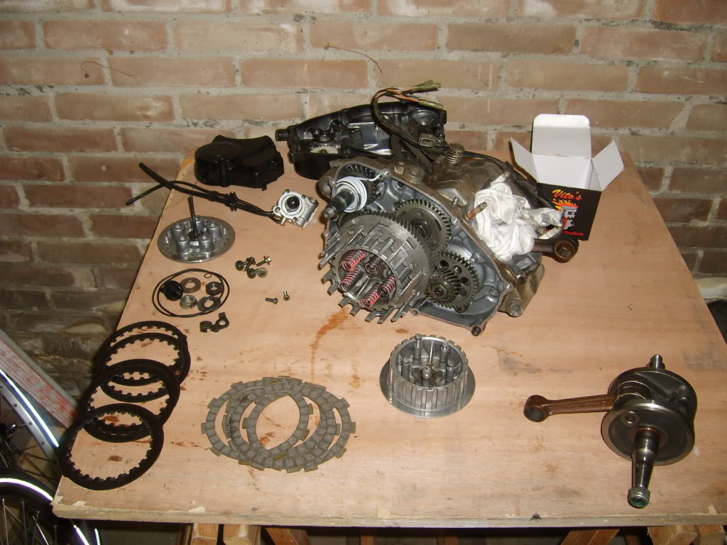

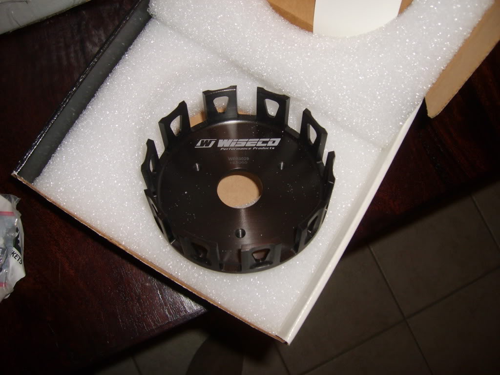

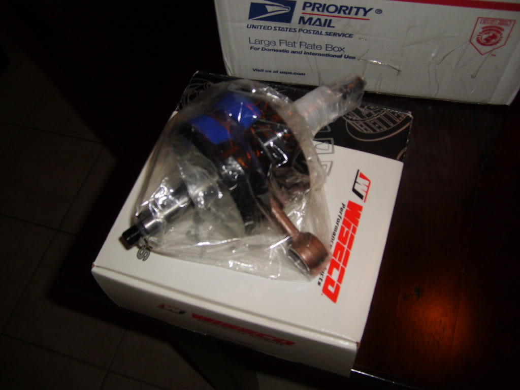

today the last parts arrived to build my new engine I:II:I
this is what i already have:

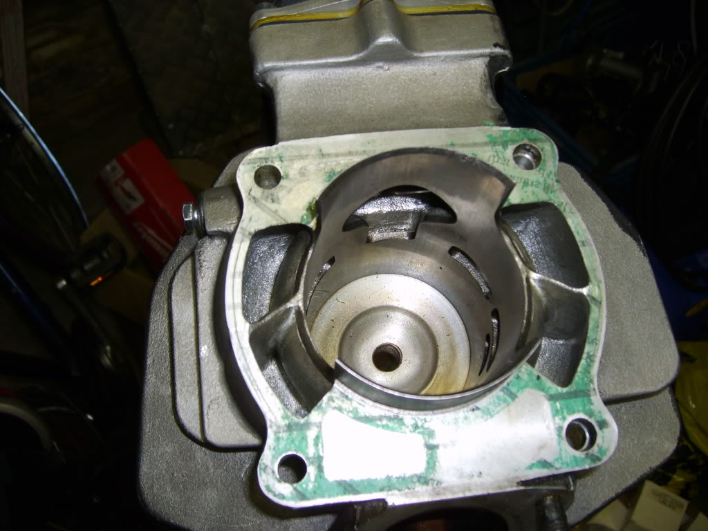

only ome thing i still have to figure out is how to adjust ports to the longer crank can anyone tell me how its done??
you send it to a build and have them port it for the longer stroke.
looks like a nice build you have going.
today someone told me it was just putting the degree wheel on with original crank write down port degrees then put the bigger crank in and match the ports so they open and close at the same degrees as with original crank
is this the trick or is there more to it??
well it wont work like that, because since you are using the same jug, you will never be able to make them open and close at the same degrees, you can get it close but not the same.
