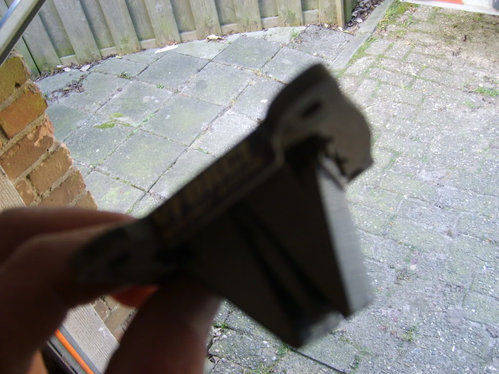

tell us more about this ignition setup... im really curious how that balancer does too!
how much was it? so your still installing it?does it come with 2 maps out of the box?
it costs about 200 dollar there is a loose wire if you conect it to ground
it changes to map2 otherwise map 1 map 1 is good enough map 2 is for the extreme
a friend of mine has it on his scooter and went from 16.5 horses to 22 only changing his ignition from stock to hpi

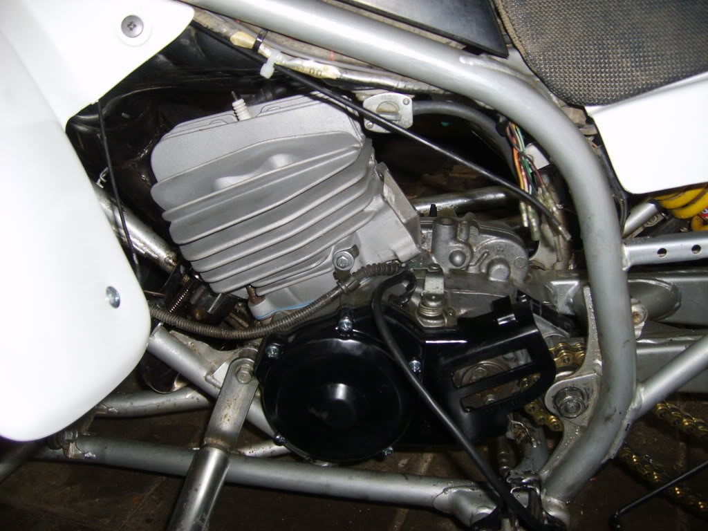

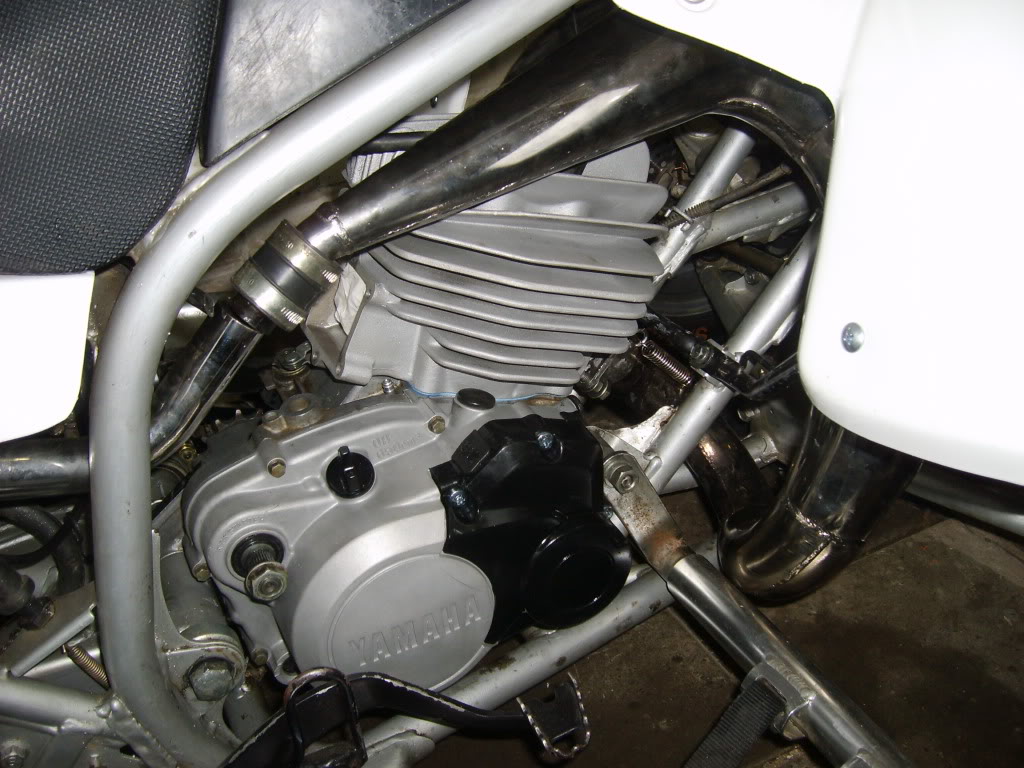

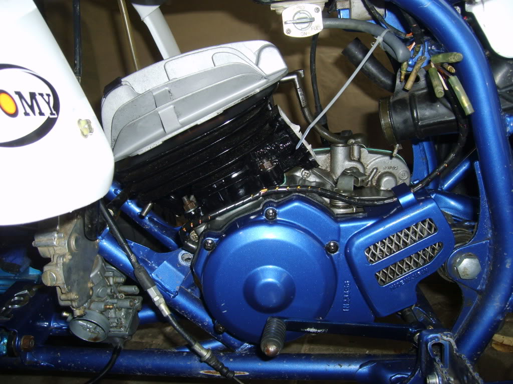

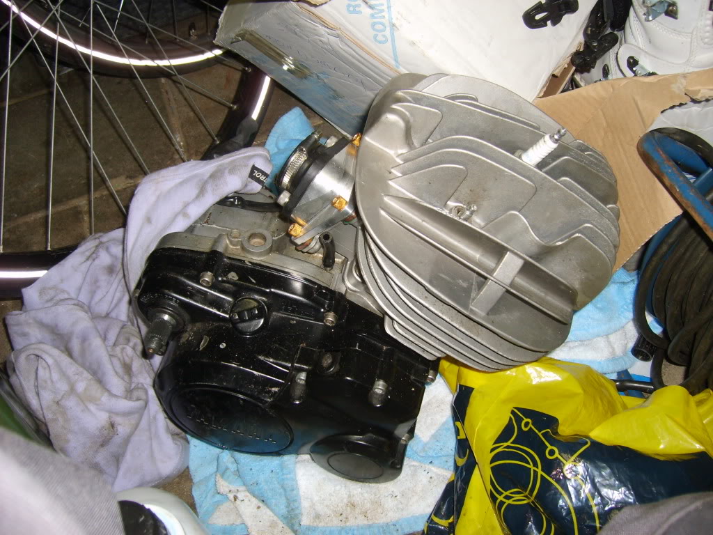

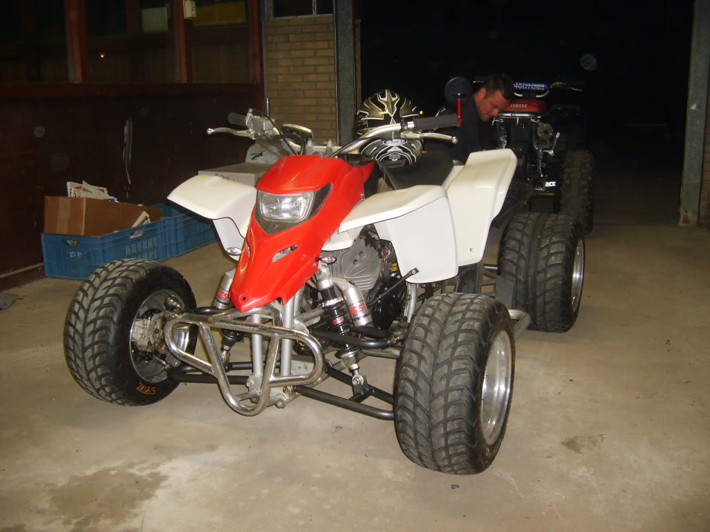

this is how far i got so far on the red white blasty

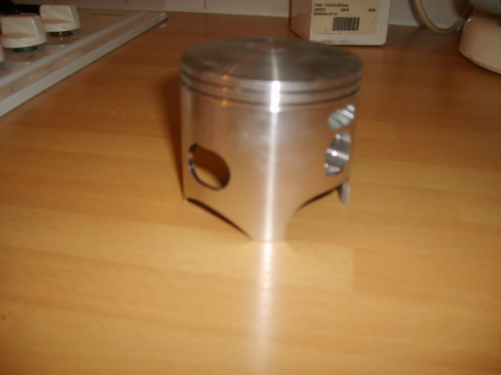

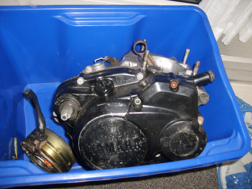

my other engine a ported vito's with wiseco piston

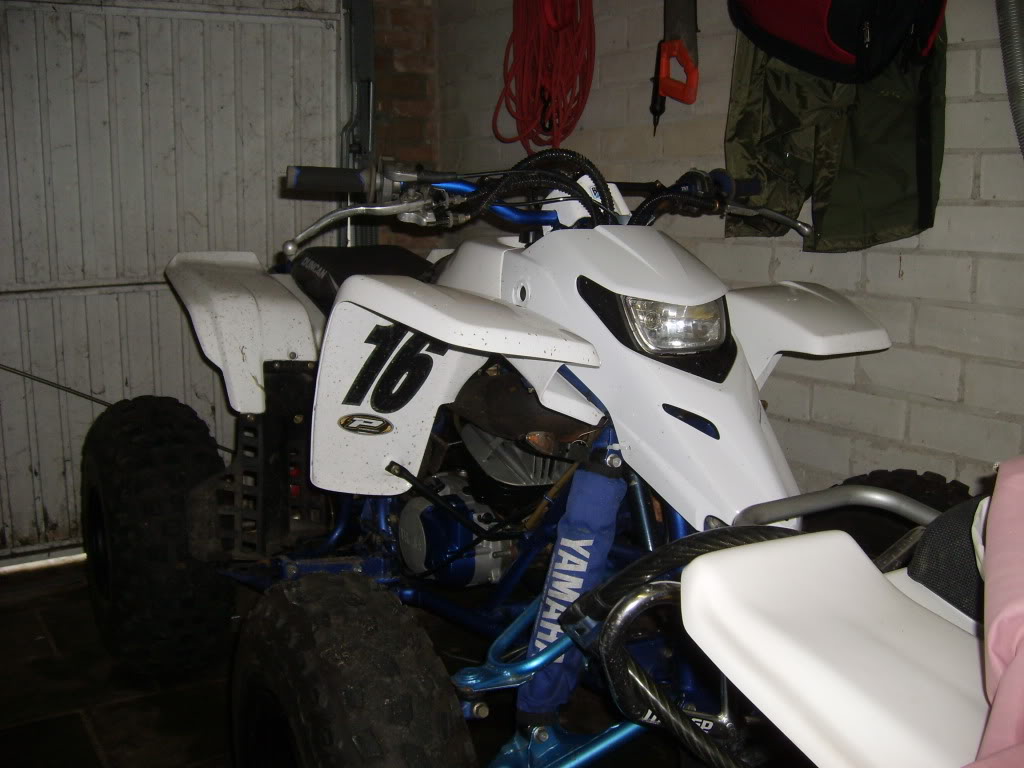

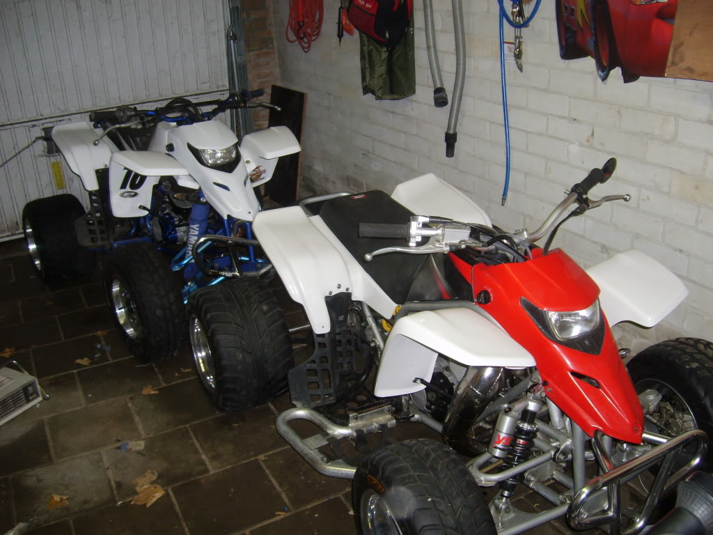

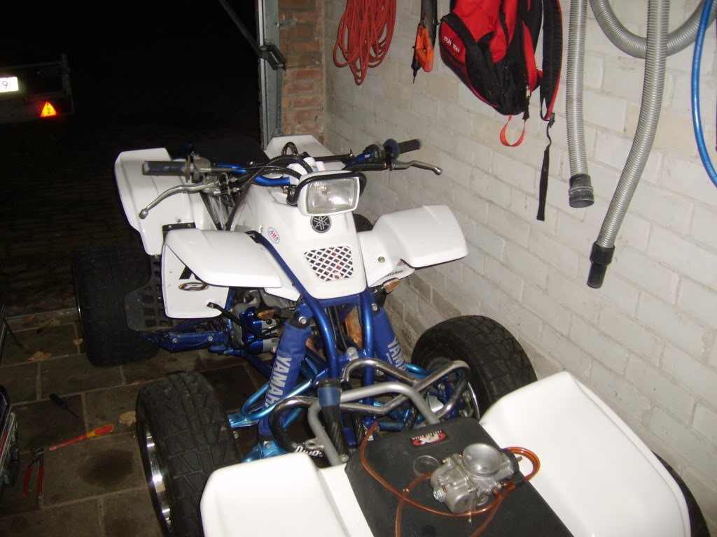

the blue white blaster is riding again!!!!

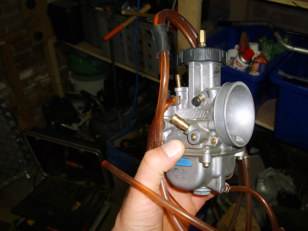

you mean this carb?? it is a 36mm keihin pwk
it works fine with the ct240kit
if your cilinder is stock it won't work you better use 28mm max

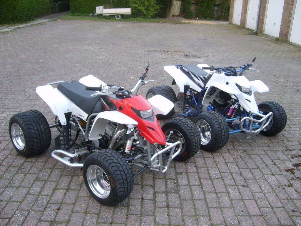

the white /blue blaster has a 200cc airsal kit i'm using a 32mikuni on that one;)

the blue/white one i use to go to work the other one i can't use for it it's a 25 km ride i'm not gona make it back with one tank of gas ;)
