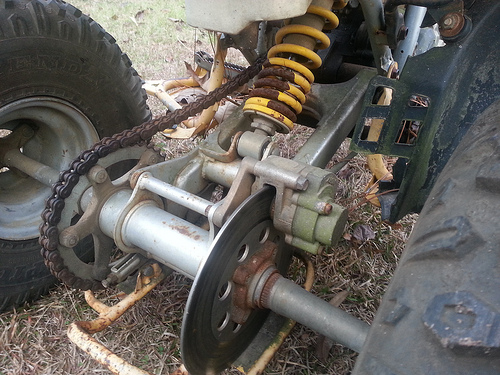

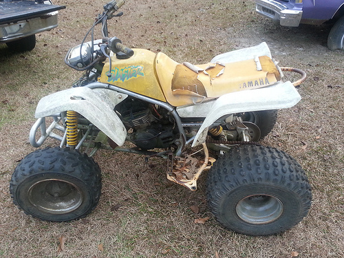

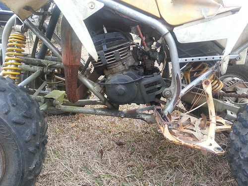

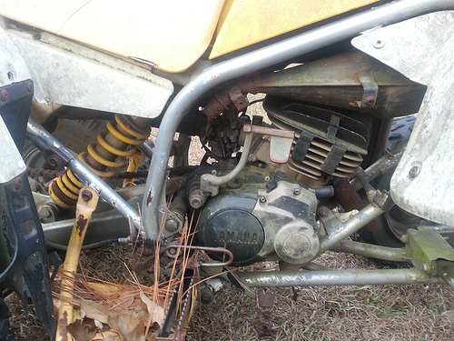

Sup Guys/Gals! This is my first post as I just recently obtained a Blaster for the price of gas to pick it up I:I ! Unfortunately, I don't know what it is that I have as far as the year/model. I only know that it needs A LOT of work and I plan to give it a full rebuild. The owner said it needed a new top-end since someone put too large of a sparkplug in it and... well you can guess the rest. I've attached some photos below.

welcome to BF.
i can't call it on exact year, there's a vin # on the frame rail below the shifter area, you can run that here for an exact year...........
Yamaha VIN Decoder @ Motoverse.com
blasters ran from 88-06
thats definately a 90-02, evidence by the metal heelgaurds 90+ had, and the cable brakes all 88-02's had
but they are basically all the exact same, except 03+ had hydro front and rear brakes.
