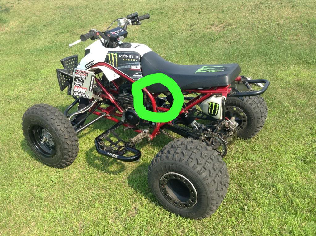

I just got a 04' blaster i put on nerfs and 18 inch tires along with handlebar risers, what could i get to add some power?
if i take the air-box lid off do i need to buy a new carb? or just some new jets? if so what size jets? and what exhaust do you recommend for cheap?
