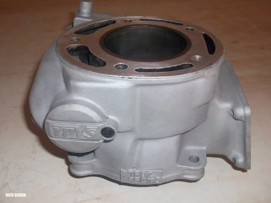

hello people of the forum, my name is nicolas ochoa and I'm from Buenos Aires, Argentina
I come to ask, and this certainly made ​​this topic, but I need to know that V-force 3 is used for the DT200, I saw many adapt the cylinder of the blaster , and put V-force.
please i need to know that V-force is adequate
mi cylinder.
cylinder of any partner of the forum!
bye people

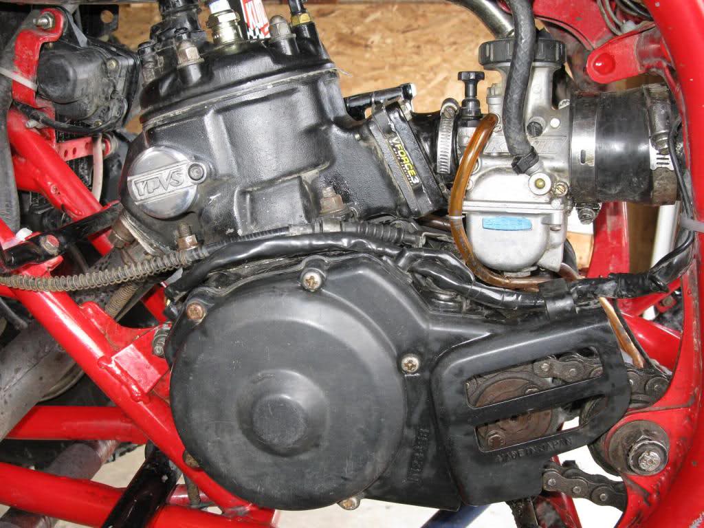

the V-force using the blaster could not go to the DT200, porr example the picture I uploaded the blaster with the V-force? which is

The Blaster and DT200 do use the same reed cage.
If it fits the DT200 it will fit the Blaster.
The DT200 runs at a slightly higher RPM and would likely make good use of the VF3 reeds.
They would likely only help a Blaster if it was ported and head work.
On the KTM bikes they only make a very slight difference and it is often a matter of debate whether they actually made an improvement over the Boyesen or stock reeds.

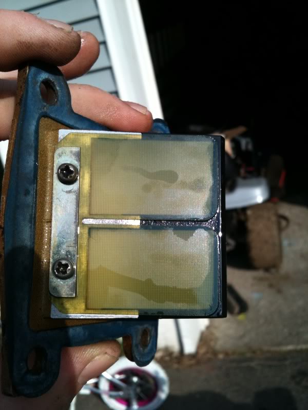

If you see that sticker that says "V Force 3" on the side of the reed block, it is likely that is what they are. Otherwise, you would have to remove them to check them.
The VF3s look like this:
Stock Blaster looks more like this:
images
I believe there is a gasket on both sides of the reed block.
This is to the cylinder, not the crankcase.
Here you can see the gasket:
