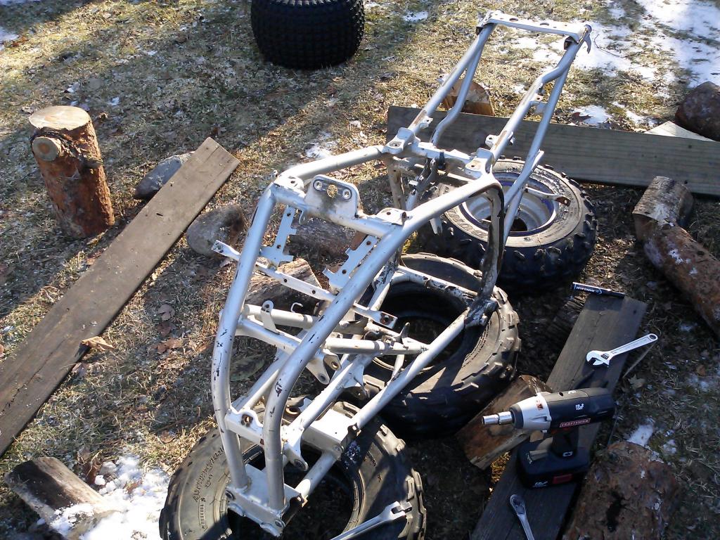

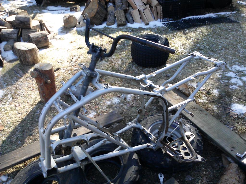

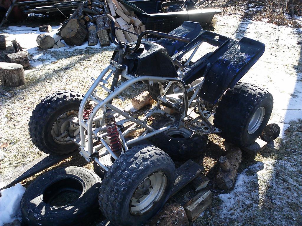

Good morning everyone! As you all know, I am planning on gusseting and painting my rolling chassis as part of my project. In order to accomplish either of those, the rolling chassis needs to be entirely disassembled (and stored until I have enough money to continue working on it). I spend all of the daylight I had yesterday working on tearing everything apart. Here is a little write-up of how everything went. WARNING: LOTS OF PICTURES!
BEFORE:
AFTER:

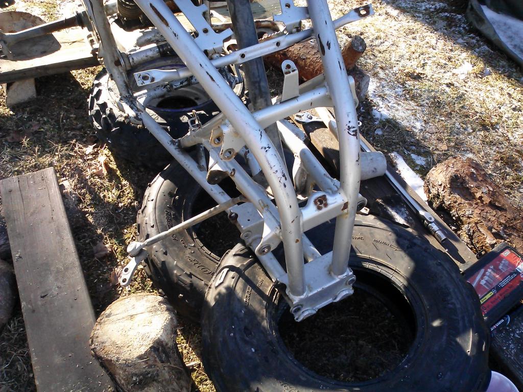

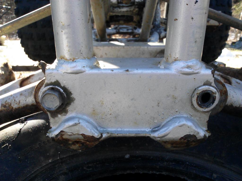

I started this mini project by inspecting the frame closely to see if any nuts/bolts were missing. My main concern when buying this rolling chassis was to make sure all of the actual components were in good shape. I'll be the first one to admit that I didn't pay much attention to the hardware that holds it all together, and I did notice after a close inspection that several nuts/bolts are missing or not OEM. I will need to replace at least 1/4 of them. Here's an example of what I'm talking about (I hadn't removed anything at this point):

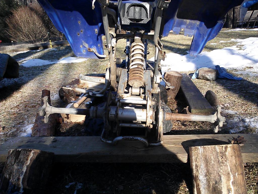

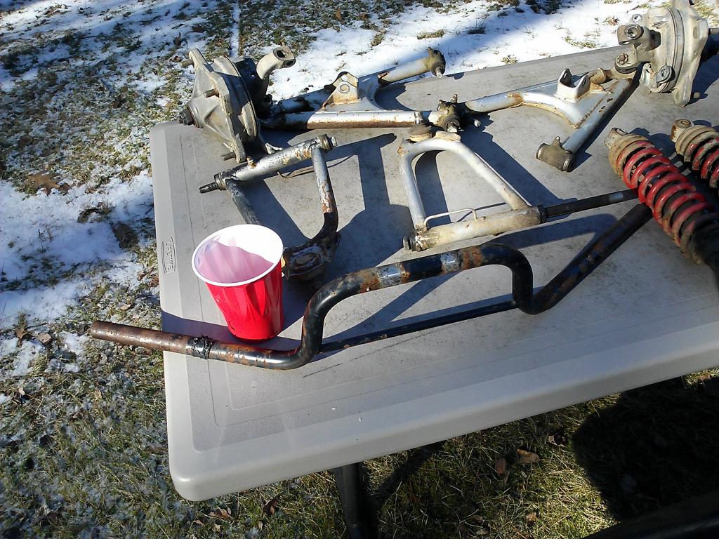

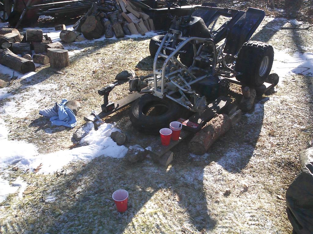

After an initial inspection, I pulled the front wheels and tires off (because one of the lugs on a rear tire was rusted to hell and I had to use some PB Blaster to loosen it up) and immediately started to disassemble the front suspension. I didn't have trouble with any of it. I was using an impact wrench and a breaker bar to remove everything, and almost all of it came apart without a hitch. No bolts were sheared apart while disassembling the front suspension (which became a problem later). Here are some pictures mid-disassembly:
After the front suspension was taken care of, I managed to finally get the lug on the back off and pulled the rear tires. I then went ahead and took the swing arm off (which was a MASSIVE pain). In the process of removing the swing arm, I noticed a couple bolts in the main frame and tried to take them off. I ended up shearing both of them in half and now have no idea how I'm going to remove them. They're very rusted too, so I went ahead and threw some PB Blaster on whats left in hope that a miracle will help me take them out. I'll keep you guys updated.

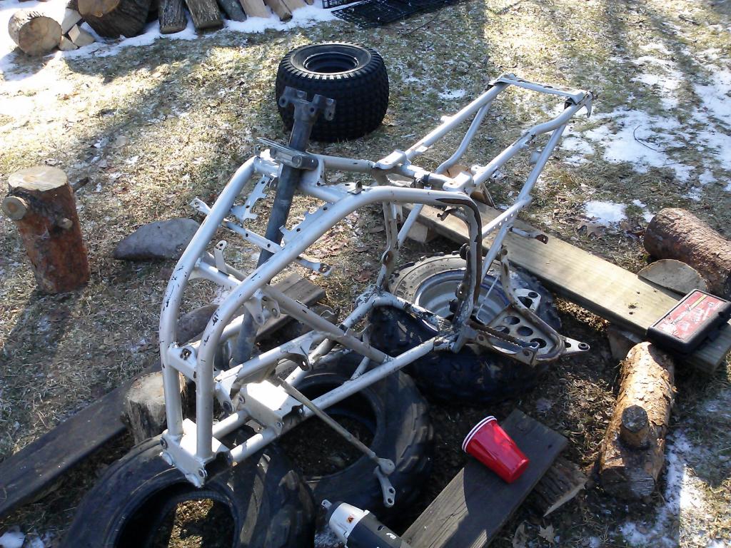

The final major step in disassembling my rolling chassis was to take out the steering column and handlebars. I thought this part would be much more difficult than it was. Aside from the little metal clip sitting underneath the bolts that mount the column to the top of the frame, everything was relatively easy and painless. I also took off the foot peg that was on the left side of the frame during this step.

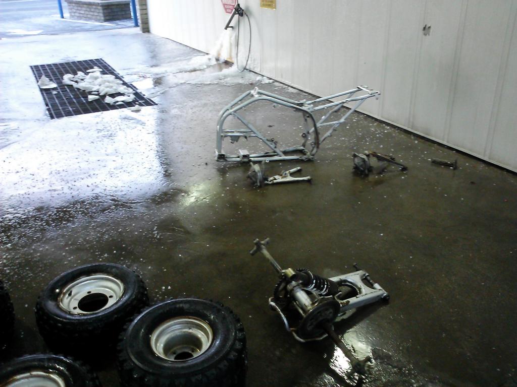

FINALLY, my brother and I drove to our local car wash and power washed all of the components before I wrapped them in an old fleece blanket for storage throughout the rest of the winter. Here is a picture from our car wash adventure:
