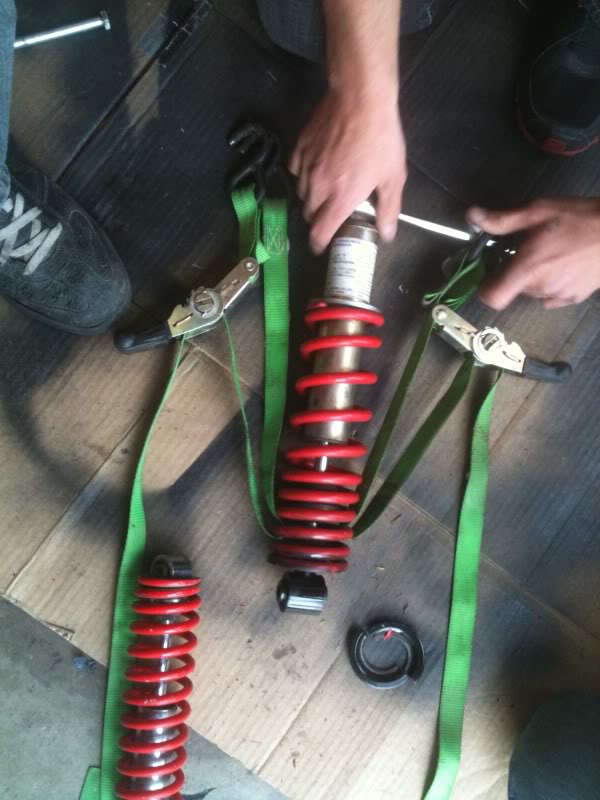

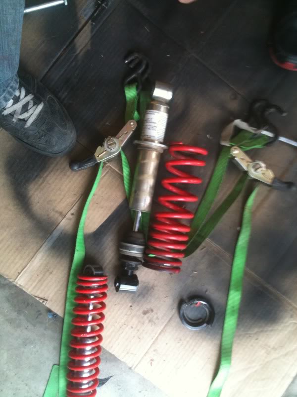

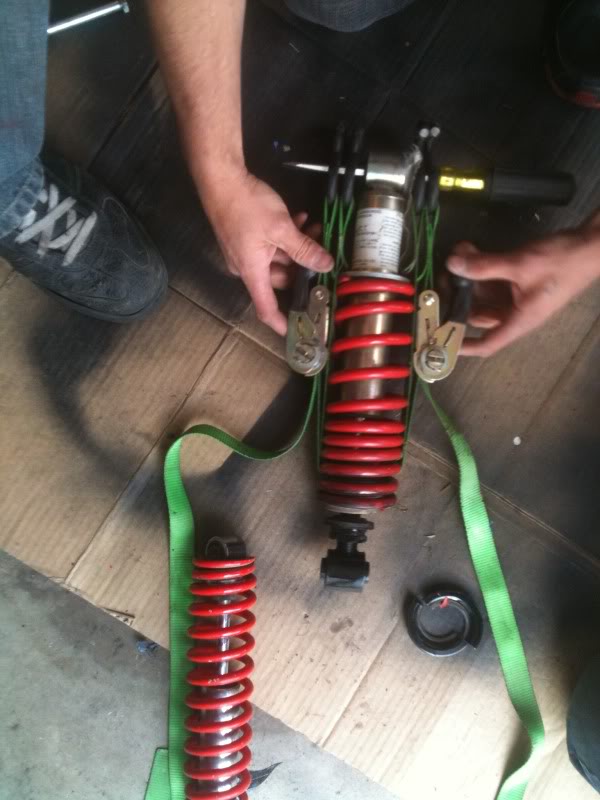

Ive found a great way to tear down any shock with out a spring compressor. Check it out step by step
Materials---
--shocks to tear down
--long bolt approx 8 inches long(big enough to fit through your shock mounts)
--2 ratchet straps(tie down straps)
Step 1
Use an old bolt and run it through your bottom of the shock
Step 2
run your straps through your springs and reconnect them to the ratchet on both sides
Step 3
-- Slowly tighten each strap evenly
Step 4
-- Tighten down both straps until the upper washer is loose to pull off
Step 5
-- Remove your straps with an even pinch on each side to release them to remove your spring.
That is a most excellent way of doing it! , i had coil spring compressors but that messed up the paint job i did on it....
man I wanted to do this someone told me they were under a lot of tension and it would be dangerous I guess they were totally wrong. It doesnt look like they are under much tension at all
You wouldnt want to compress the spring all the way tight with them, that would be dangerous but to get enough slack out of it to take it apart would be easy..
The stock shock spring is dangerous! my compressors one of the ears bent and the spring flew off whizzed past my head, took the shop light out and blasted through some particle board, Please be careful! It will hurt you!
