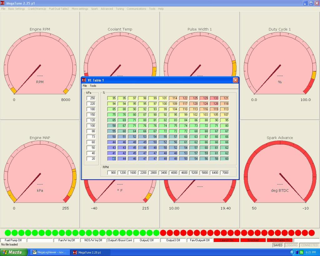

The older mazdas use a VAF flapper to meter air going into the engine. I am running megasquirt for fuel/spark it has a built in 2 bar map sensor. I could upgrade to a 4 bar sensor easily but I would lose resolution on my tuning tables. In the MSExtra code the tables are 12x12 (8x8 in normal MS1) I would have to set the rows to cover larger increments to work with the 4 bar map.
Now they are from 0-250kpa in 12 increments, I would have to set the ecu to 0-500kps in 12 increments so the fuel map would be clunky and less accurate.
100kpa is 0psi (wide open throttle in a naturally aspirated) changing to the 4 bar would give me 5 rows to step the boost fuel which isnt enough. I could upgrade the processor to a MSII and then run the MSIIExtra code for 20x20 tables but I still dont need it simply because I'll never run that much boost..
This is what my fuel map looks like in the tune software. That is what the car ran 13.1 on.
