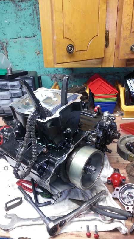

Awk my debate is more along the line of ; do I attempt to broaden the power curve with the cam or just emphasize where the motor is already going to peak?. You are absolutely correct withthe stage 2 cams. That is exactly where the power curve will be the strongest. Im more just unsure if i should attemp to widen it a bit or just go for all out mid range power.dont get me wrong its gonna be nearly double the stock hp no matter what cam I chose.
@Quadman1 whats it need and location and how much.this prodject will be finished by the end of august and i really want a zilla. Id like to have a 90 but 87 can be builtup.
Question might be best asked of your porter/builder.
Hard to get the best of both worlds.
S3 sounds like a drag only or drag/hill shooter style.
S1 might not be bad even.
No matter which way you go, be sure to check valve/piston clearance.
Clearances arent any big deal. The yfz's use shimmed valves. And im the builder lol. Sent the head to get ported but just had it opened up to breather better. I am torn between all 3 options. Stage one will bring the power on earlier but not peak as high. Stage 2 will peak super high in about a 2500 rpm range and stage 3 will stop it from falling on its face near max rpm but not as strong of a peak as 2. I was just currious if anyone had tried anything close to what im doing. Worst case scenario If I dont like it I can buy another set. But at 400$ a set I am hoping to get it right the first try. I am leaning toward 1 or 2. I hill climb and drag but 99% of my ride time wi spent with my lil 3 yr old buddy in front of me just putting around the trails and he points at everything he sees andsays " dabby wook at dat!" Lol

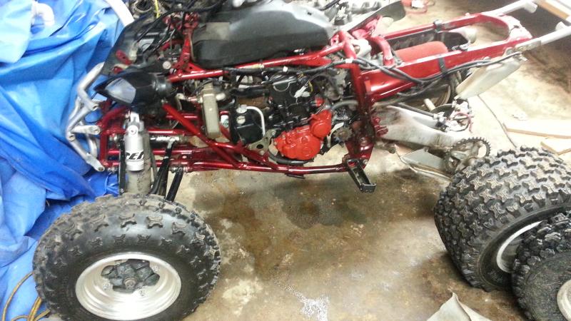

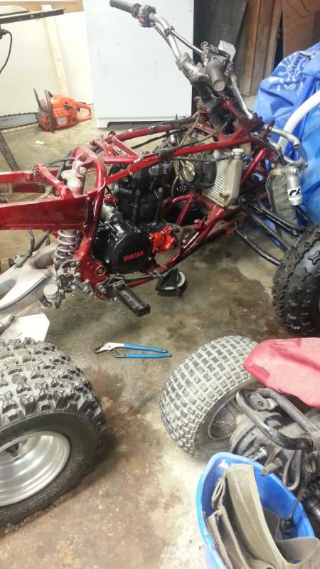

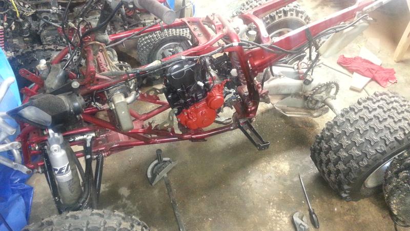

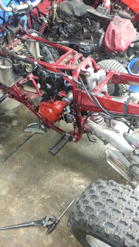

ok it's been a while, i got a promotion at work and it's taking all my life but i have gotten some work done. to quote Dr Frankenstein " ITS ALIVE!" but not quite finished. got some major jet issues to work out. it's running super lean but it runs and it's strong. i should pick up a few more horses once i get her tuned out.
nice !
keep us posted as you get the bugs worked out
Congrats on the promotion! The YFZ is looking good, just remember when your stressed out at work, you can always relax and play with your quad! That gets me through many a work day.
Ok update. I worked untill midnight last night and got the jetting close. Actual displacement is 563 cu in. My jetting is as follows. 52 piolt and 174 main. The exhaust was faintly glowing at idle after a few minutes so its pretty darn close on the pilot. After about 4 passes up and down the road it was cherry red again so need to step the main up a bit yet. Keep in mind 2-4 inches glowing red is normal on these, just not the 8" I had lol. Cool thing is that it stands straight up in every gear at half throttle Not dropping the clutch. Gonna have to change my exhaust though, the drag pipe is deafening to ride on. May richen up a bit once I change pipes. Gonna add a tooth to the front sprocket as well. I was topped out in 5th in a blink. She needs a little longer legs.
