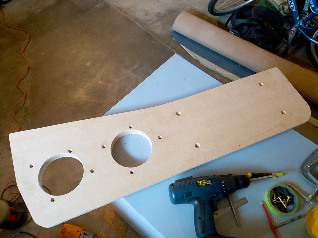

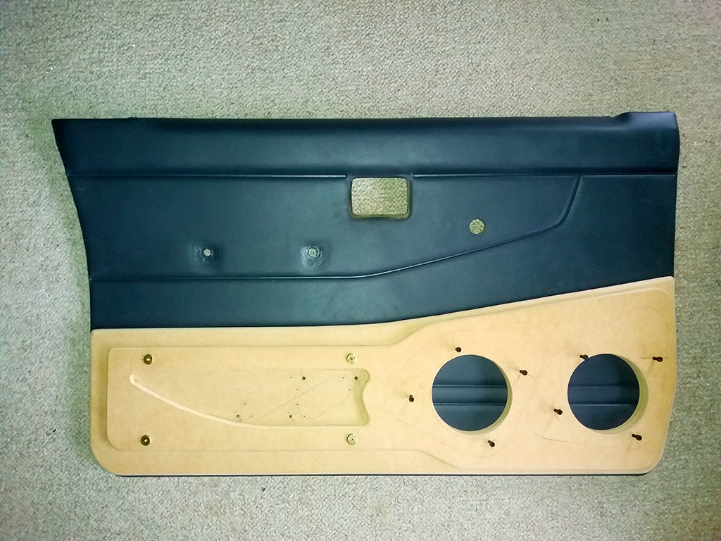

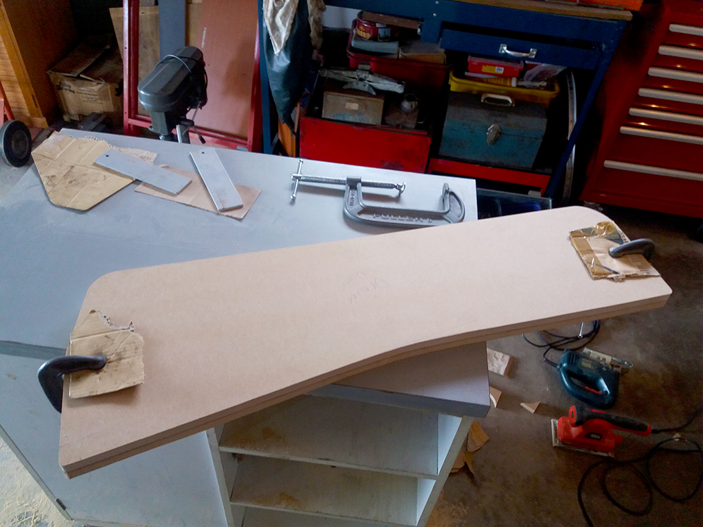

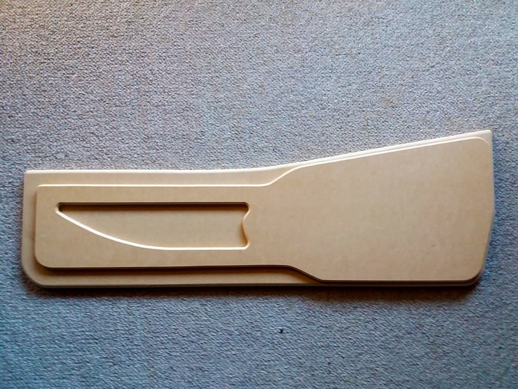

Spent today in shed measuring, drawing, cutting, routeing, sanded. Dust all over shed and me. :rolleyes: Picked up a roll of 14g speaker wire today also to replace the stock smaller stuff with the speakers. Also ordered a SanDisk Ultra Fit Flash Drive, 64GB, USB 3.0 to put all my music onto. Ordered this one as it will only stick out about 5mm out of the head unit when plugged in. :)
Going to be mounting the component speaker crossover in the cutout part.
Tomorrow I will be drilling screw holes and cutting speaker holes in the boards and buy some material to cover the wood in.
I cannot wait to get installed and running. Plan on doing the rear 6x9's after getting the front speakers and head unit installed.

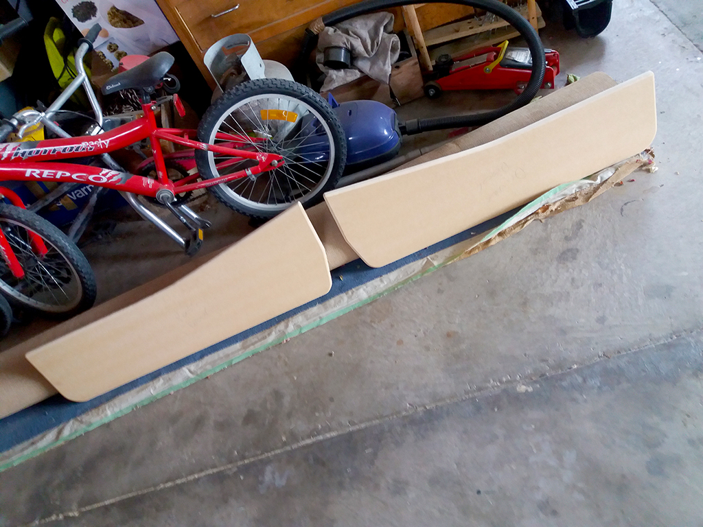

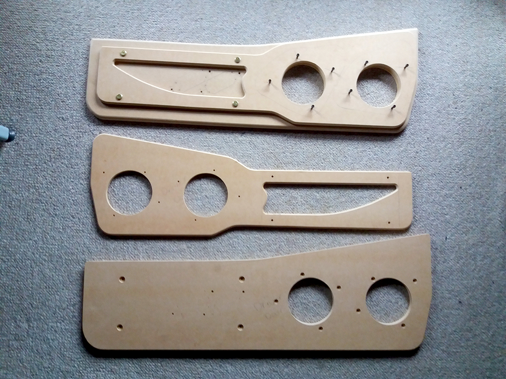

More done on it today. Brought the material to cover the MDF today and also a couple of plug connectors.
Drill steps for washer and nuts for holding the speaker pods on.
Cut the speaker holes and drilled all the needed holes.
Tomorrow I will be drilled holes in the door panels for the speaker wires and screws to mount it all.
Hope to start covering them tomorrow.
