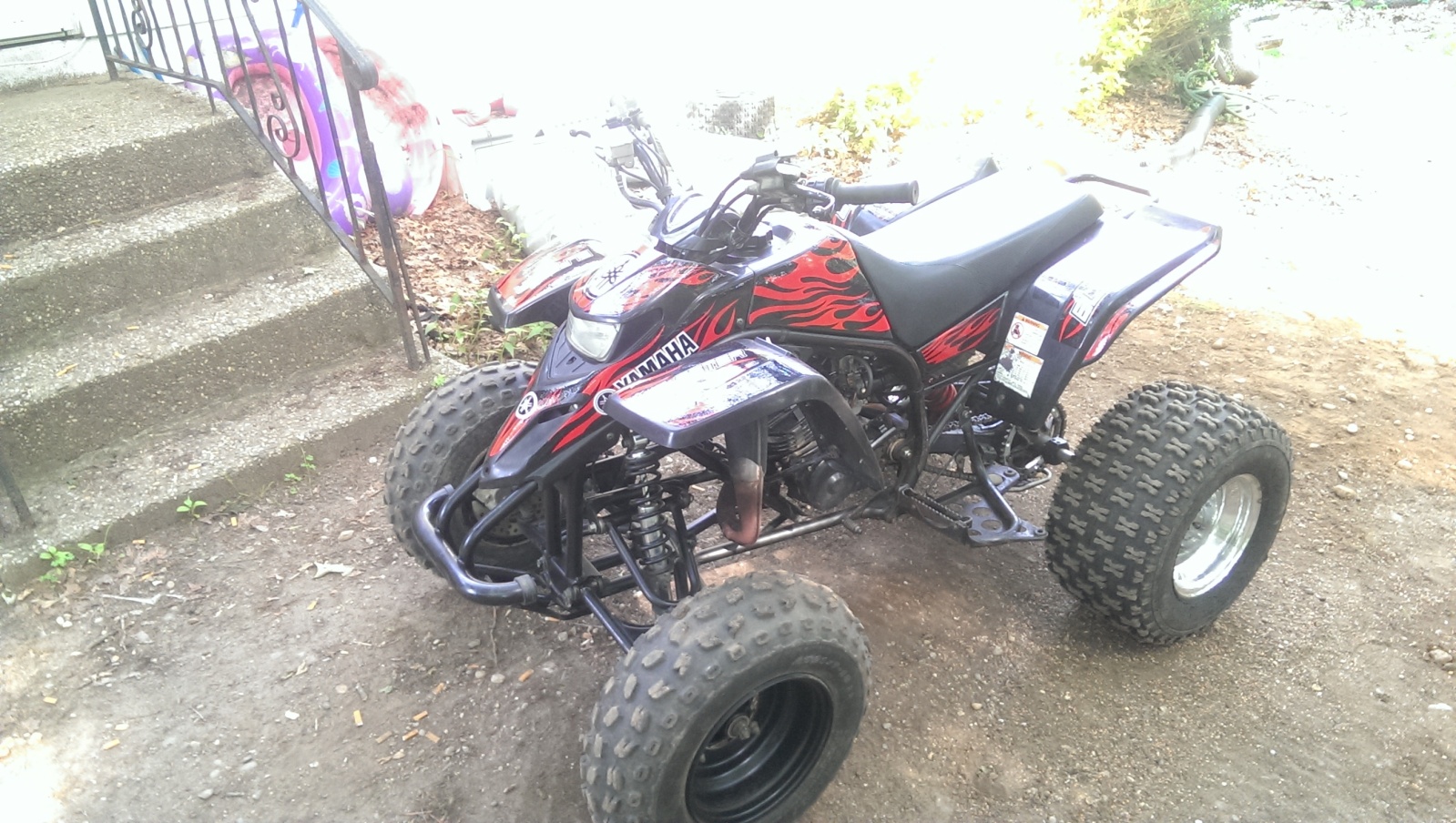

Ok everything is on. Even the 400ex shock now. Just waiting fo my used fatty and powercore2 to arrive
she looks like a virgin.
once you get that pipe, you will get the disease
the.. the.... THE MOD BUG
I know the disease but I know the limits of the blaster. I have a worked 'cr250 that's my racer. This is my have fun quad.

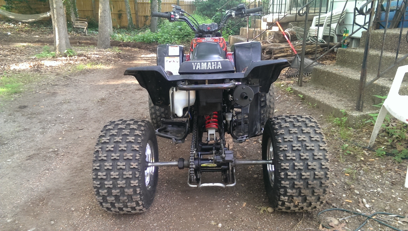

Well for now I am done with the blaster. Got some boyeson reeds, and the Exhaust showed up yesterday was worried for 150$ for a full fmf fatty and it was installed (minor sanding and some HH paint). I just need to jet it but I drove it a few times and I am more then happy with the results especially the shock /tusk spacers and bigger rims and tires. Until the top end goes my journey is over, then its going to Oconner for port polish and head milling. , bars and clutch lever have to go too but thats it. Here's a video of she looks I was satisfied with the way it grabs . Even the 25$ eBay stickers were worth it. Total cost of bike 1400.
Finished 2006 Blaster SE:
