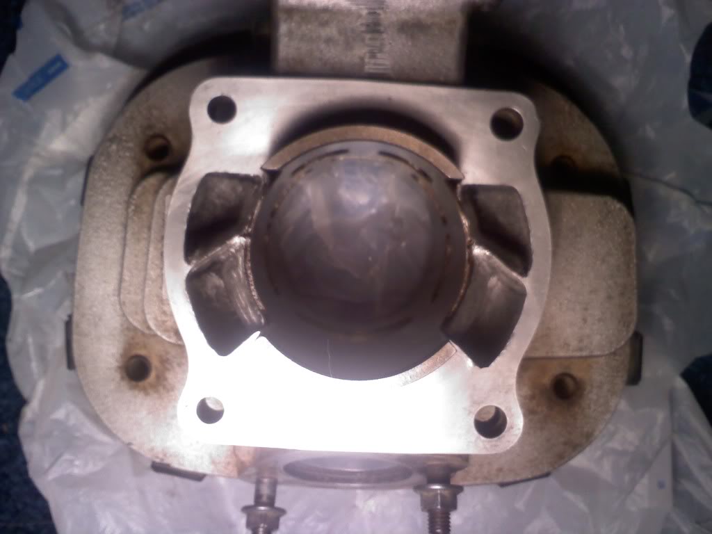

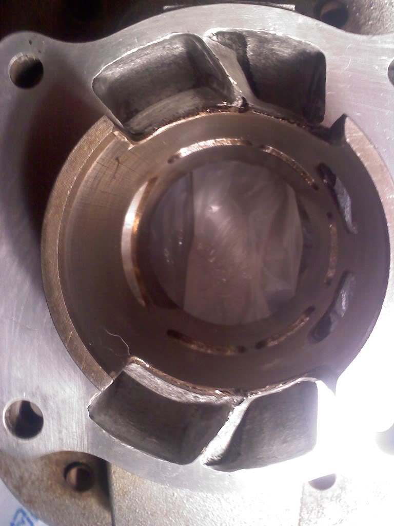

well i still need to get the jetting dialed in perfect its on the rich side as of now but il put up a quick reveiw on it and update later when i get it tuned perfect.
il start off by saying at first in the lower rpms its casual about the same as before, but when it starts to rev out it just pulls like crazy in the mid range and top and im in love with it. new pipe and bigger carb should wake it up some more
it has more then enough power where i need it when i need it i hit the gas it goes, i wana go sideways i go sideways i wana launch into a tree like never before i launch into a tree like never before
i can throw some crazy roost up now without a problem.
he did a great job on it shes a ripper for sure cant wait to hit up some good trails with it, AWK moutain soon im hoping see what she can do there.
i give matt a huge thumbs up for it and cant wait to get out and kill me some 4 pokers

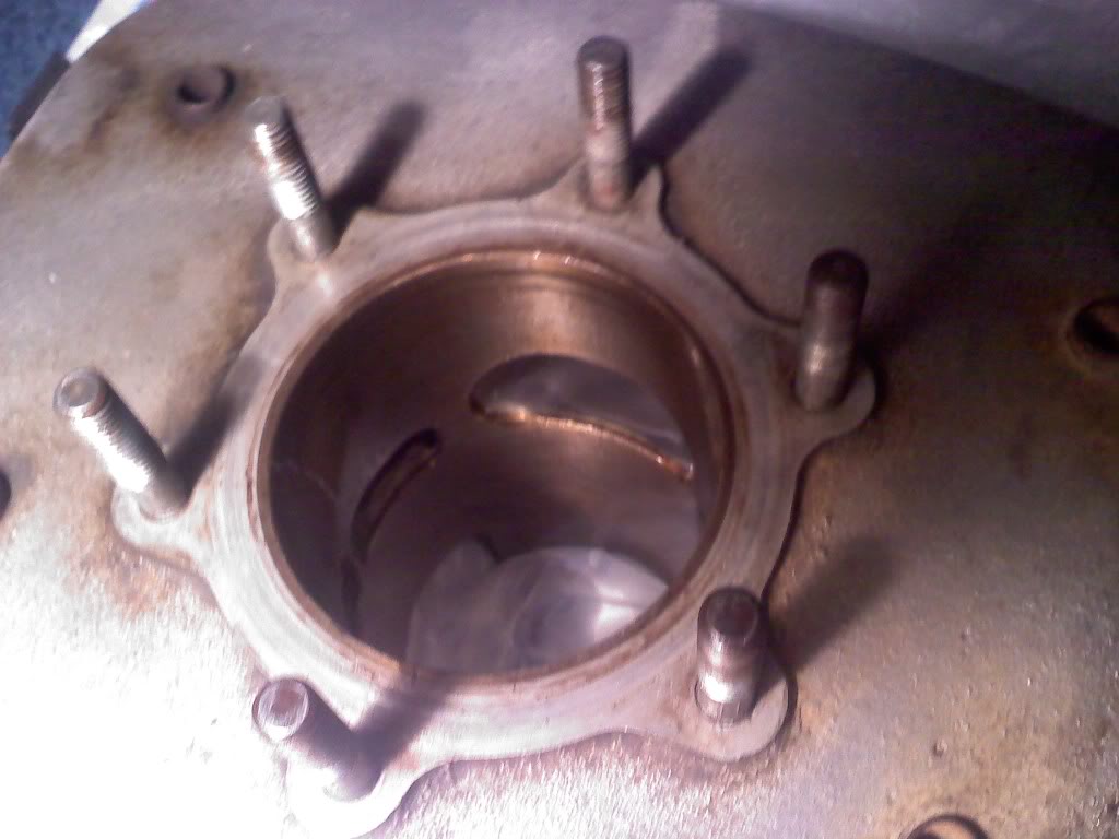

heres some pictures enjoy

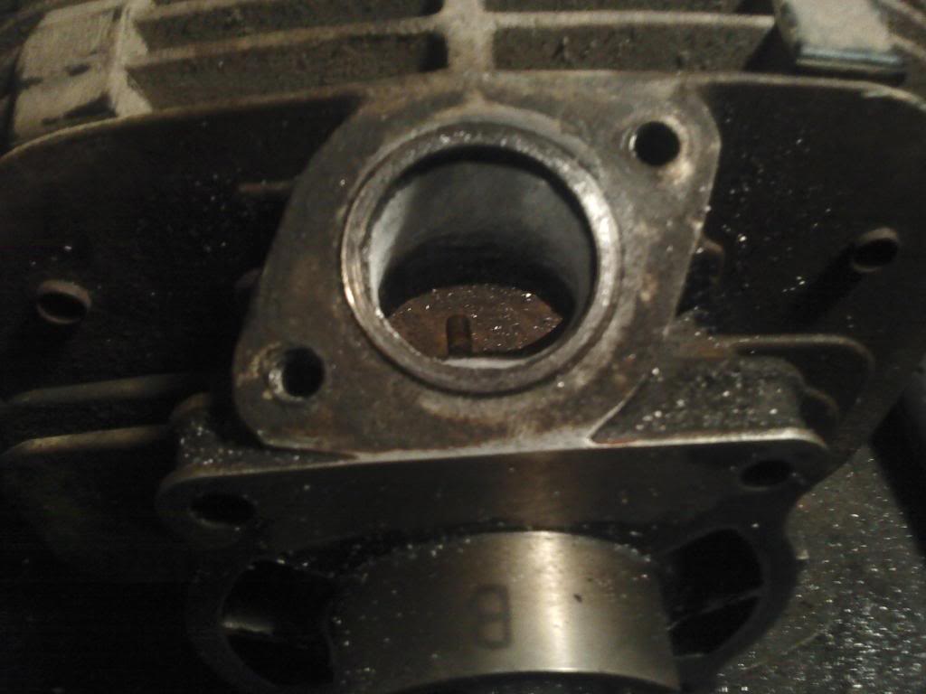

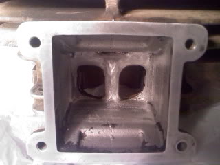

transfers
redisgned head from ken

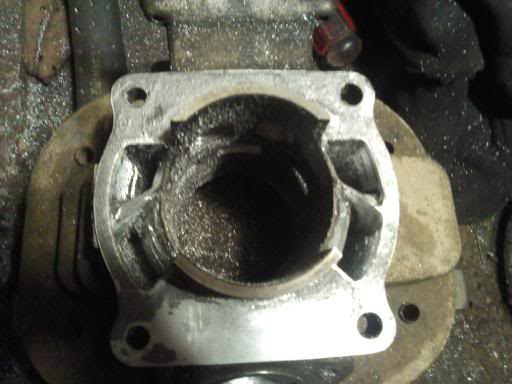

heres a few more before it was finished

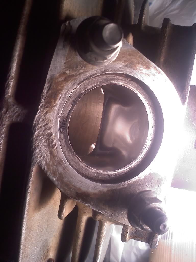

ok heres one intake doesnt do much of anything from what i read just a knife edge on the bridge no boysens or anything like that
We dont know what hudack was doing with his newly ported cylinder with all the smooth ports, so we hope that is just dog hair..lol
correct, the intake is not going to change power output that much no matter what you do to it. also there is more work there than just knifing the bridge. thar upper boost port has some time in it, plus just getting it to flow better takes some manipulation. I:I
