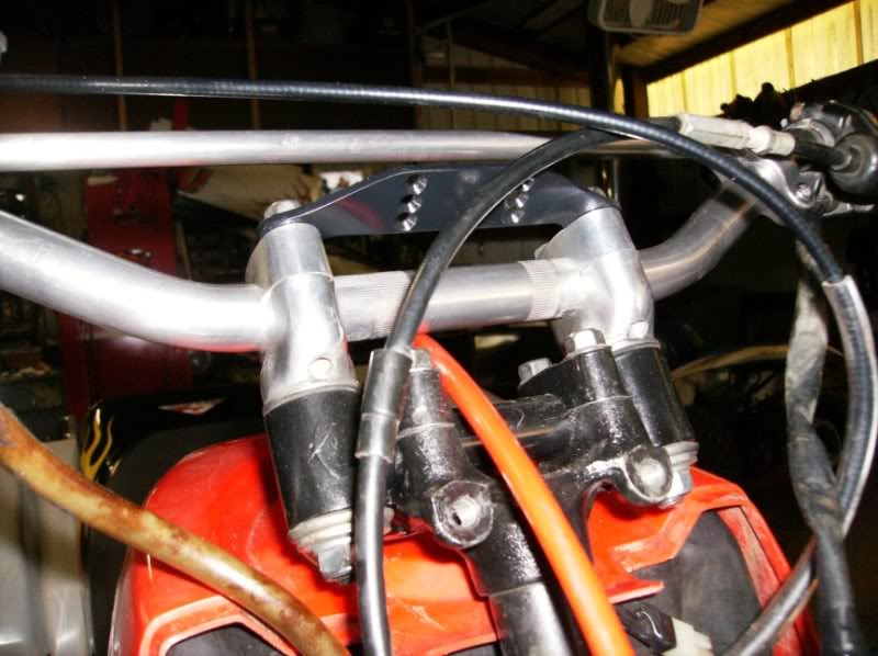

One of the best things about a Blaster is that it's small, but I have long legs and without raising the seat I'll always feel folded up on a Blaster.. What they said ^^^^ +4 & +1 ... might also try rotating the bars forward for a bit more arm room.. The grips will be at a wierd angle but would give the feel of it.. Might be able space the top steering stem bearing forward & tweek the bottom one..
I made an anti-vibe adaptor that allows me to move the bars forward a couple inches but it does change the steering feel somewhat, moving the bars off center line.. Always a compromise :)
Here they're in line with the stem but it's easy to move them

Handle bars feel good where theyre at i flipped the mounts.
