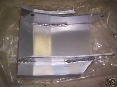

hahaha u can weld and weld but without reinforcing the mounting holes that nice skidplate u just spent hours on is gonna get ripped off anyways.. :o :o. take a look at what happened to mine within a few hours of being on the mountain last year.. lol thats 1/4" steel plates welded on it but the whole thing got bent :( lol

yep........i just had a fairly good shape one fail just like that at the rear mount
so my new one will be completely new, not a reinforced stocker
solid one piece floor plate with 1/4" plate rails that will bolt thru onto the swinger, < which is kens T-Rock swinger, made from 1/4" also, so i think the weak link on this one will be the bolts ????
we shall see, the whole challenge of my builds have been to withstand the mountain, sad but true, it's where i have to ride, and changing my riding style won't be any fun, so stronger i must build !!!!!!!
i'm thinking sumthin very similar to this except 1/4" steel ????
i think that if you address the mounting tabs it should hold up, i liek the sounds of what u are planning. i thought that plate was gonna be with me for life but newp lol :o :D
yeah those blingstar items are definately name brand reflecting on the price. but the weakpoint in the skids is as mentioned...the mounting bolts. maybe when you get a string enough skid you should weld it directly to the swinger.

I too have been contiplating making some "ruff ryders skids", Just have soo many things going on... Hell I haven't ridden in a month! 1/4 inch will work great for mounts as that's what I used on my stocker and been rockin that for two seasons! The raptor one is 1/4In stainless and is welded to the swinger, that sucker is bullet proof! You on the right track Brutha, While your fabbing, cut a few pieces of 1/4" bar, weld it to the stock tabs drill the hole and give it a try, Should be good for quite a while! I just made mine too long and it hangs very low!( as you know!)
