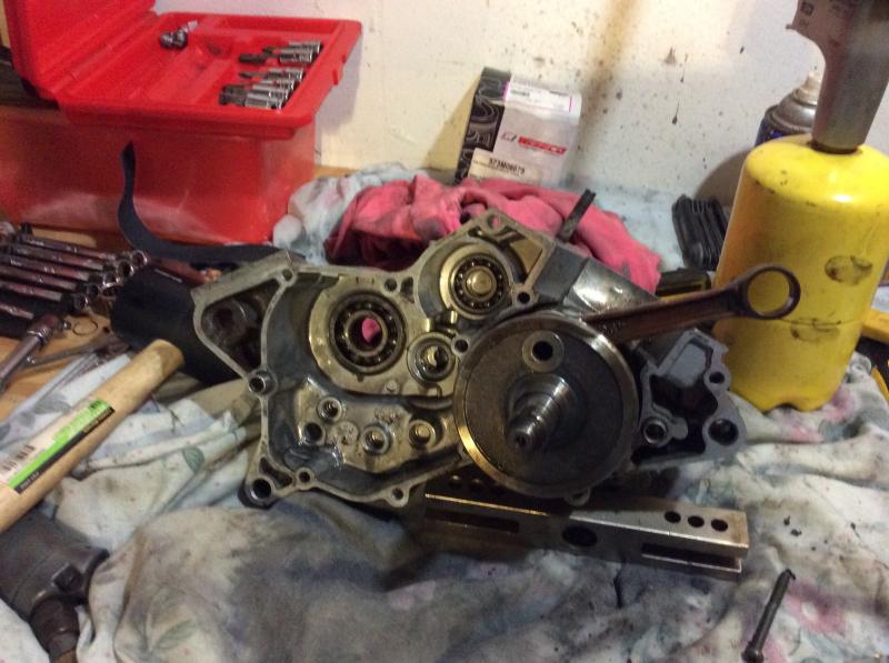

Ok go the case split and am having a issue getting the crank out it cam out of the one side no problem but this side it is stuck. Is there a trick to getting it out?
It needs to be pushed out. If you have access to a press, do it that way. That's how I do it. Do not use a hammer. I've used steering wheel pullers in the past. Just need longer screws with the same size and thread pitch as the case screws.
Someone else may chime in with a better diy way.
Steering wheel puller/bearing puller like bansheedave said or If you can find a local auto/machine shop they shouldn't charge much to get it out.. Be sure to watch the vids on how to install them and also lap the cases before install.. If you don't have a torque wrench get one you will need it and a good recommendation is to get a ss bolt kit.. E bay has them but make you let them know you want the stator plate bolts with it.. look up gasket matching and read up on squish clearance.. If you were to shave the head a bit by yourself thts ok but if to much you run into trouble. Send the head off to Kor and admire what a blaster head should look like,, and Hang on.. ;)
