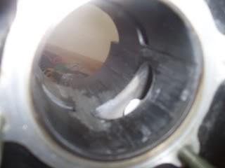

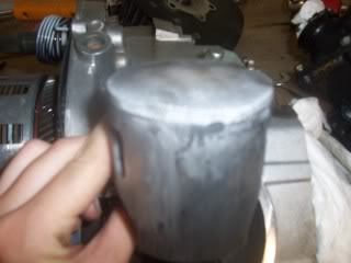

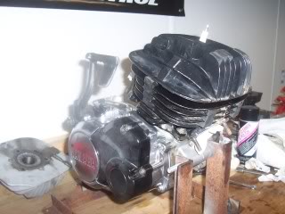

after a few months of having a melted piston we rebuilt my blaster heres the pics
let me know what you think
melted piston
cylinder wall

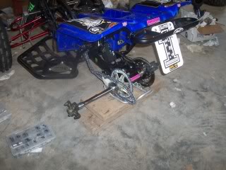

roller
no axle

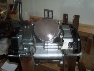

new piston
200cc airsal cylinder kit
ready to be bolted in

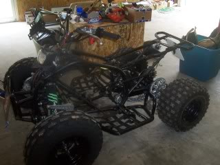

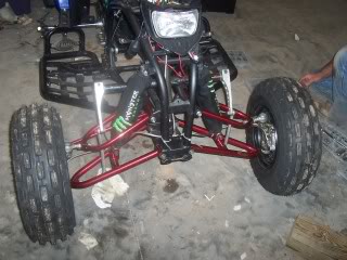

new a-arms thanks to XBLASTERRACERX
new g-force axle

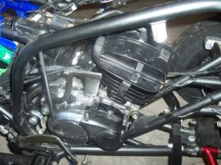

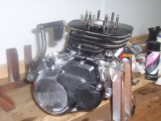

motor in
top view
started first kick and ran awesome

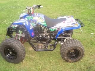

after workin out a few bugs she runs like a champ

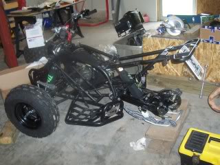

final pic of the rebuild
the rebuild of what i can think of the top of my head are
trick racing graphic kit
plastic off a 2000 blaster
burgard a-arms
pro taper grips
g-force axle
carb work
polished cover
cut silencer shorter
not so much of a real rebuild but after having most of the parts it was not to bad of a killer

im really happy with it i did buy it used but you could still see the cross hattching and honeing in it its really waken up the stock motor i think its well worth the money

that looks awesome!!! a completely new look from the way it was before, almost like getting a new quad. good work! I:I I:I
im really happy with the a-arms the shocks are really soft so i saved several hundred on works shocks mine are perfect for my type of riding now burgard cycle is a really good company just wanna throw that out there the spindels had to be reamed out to fit with the new a-arms and they done it free and shipped back free too so if anyones looking for a-arms or anything check them out they are really good people

Burgard Cycle

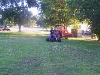

awsome. i gota be the one to say it though, havent goten any pics of you rippin yet, all we get is that far away shot at what looks to be possibly you?
have not opened it up just yet still waiting to make sure everything is gonna be alright i check the oil viewing spot after every ride and even after it sitting a cooling now it looks like i have no oil in my case so i wanna work that bug out first then i will have to get some videos and pics up
rebuild looks awesome. ive got one going on too. put the roccomended amount of oil in the bottom end, cant think of a measurement off the top of my head, then ride it warm it up completely and drain it again. measure the amount that comes out. if its the same measurement as what went in, then youre all set. i honestly think those peekhole things are sketchy anyways.
