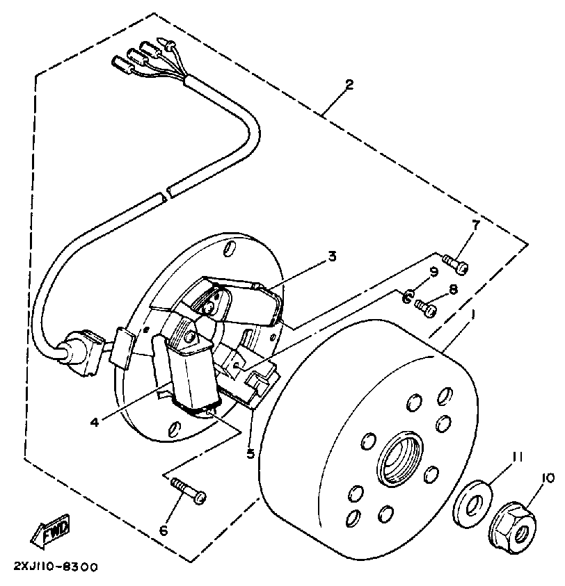

#3 is the charge coil. Is this the one you mean?? Wouldn't it be better to just replace the whole stator from Ricky stator for $125????
yep. and yes. but if you R on a budget I think that coil is like $45. Id go for the Ricky stator myself. Matter of fact thats on my list for the next purchase for my blaster.
