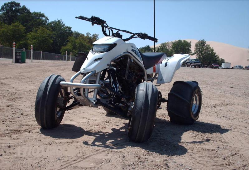

A Arms: ASR +2 up 1
Swingarm: Custom +6
Steering Stem: Chrome after market
Stabilizer: stock
Axle: +2 Dominator
Carrier: Banshee aftermarket
Locknut: Dominator
Hubs F|R: Banshee
Bars: Fly
Throttle/Clutch Lever: ASV break away-terry cable thumb and twist throttle
Grips: scott
Nerfs: custom
Bumper: DG
Grab Bar: Outlaw
Front Shocks: Works dual with reservoirs
Rear Shock: Works single rate with reservoir
Brake Lines: Hydraulic-banshee rear-raptor front
Rotors F|R: Hydraulic raptor front and banshee rear
Rims F|R: Douglas
Tires F|R: sand sharks
Body:
Frame: powder coat metalic
Plastic: maier race
Graphics|Seat Cover: custom blaster
Number Backgrounds: none
Handguards: Power madd
Bar Pad: Fly
Fuel Tank: stock
Engine|Drive System:
Cylinder|Head: Nickle-sil CT 240
Bore & Stroke: long rod stock stroke .71mm bore
Displacement: 240cc
Cam: none
Carburetor: 35mm Airstryker
Air Filter|Box: Aluminum box with K&N
Pipe|Silencer: LRD
Clutch|Plates: Race clutch
Gearing F|R: 14/40
CDI|Killswitch: tether
Cooling: air
Other: I should have washed it

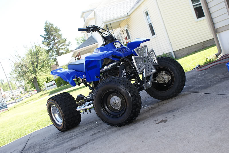

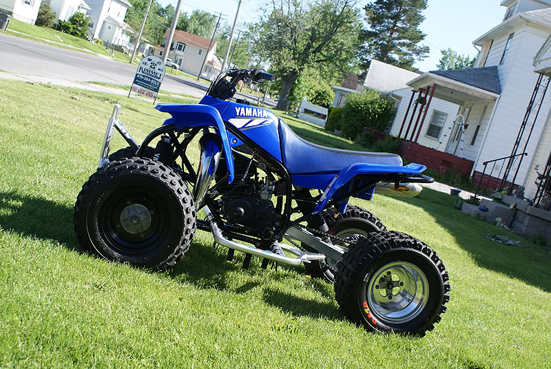

**1989 YAMAHA BLASTER**
A Arms: stock
Swingarm: stock; "swingarm shop" +3" not installed..
Steering Stem: stock
Stabilizer: n/a
Axle: stock
Carrier: stock
Locknut: LSR billet locknut
Hubs F|R: banshee
Bars: stock
Throttle/Clutch Lever: stock/ "WIRTZ" lever&perch
Grips: ODI "rogue"
Nerfs: n/a
Bumper: stock
Grab Bar: AC aluminum
Front Shocks: banshee
Rear Shock: 400ex
Brake Lines: banshee ASR stainless steel
Rotors F|R: banshee front | raptor rear
Rims F|R: Douglas black labels
Tires F|R: sandstarrs
Body:
Frame: PC’d silver with metallic flake
Plastic: 03+ hood
Graphics|Seat Cover: n/a | 03+ seat
Number Backgrounds: n/a
Handguards: n/a
Bar Pad: MSR
Fuel Tank: stock
Cylinder|Head: bored .060” | head milled .030”
Bore & Stroke: 67.5mm | 60mm
Displacement: 214cc
Cam: must have fallen off.. lol
Carburetor: stock; cpw 30 not installed..
Air Filter|Box: UNI dual stage filter | custom vented airbox
Pipe|Silencer: CPI header | Bill’s silencer
Clutch|Plates: stock from ‘05
Gearing F|R: 14:38
CDI|Killswitch: stock
Cooling: ProjectBlaster air shrouds
Other: dune ported, vito’s +3mm stuffer crank, vForceIII reeds+cage, 8oz lightened flywheel, +4* timing advance, 03+ conversion, banshee hydros up front, raptor hydros in rear, ACracing swingarm skidplate(not pictured)

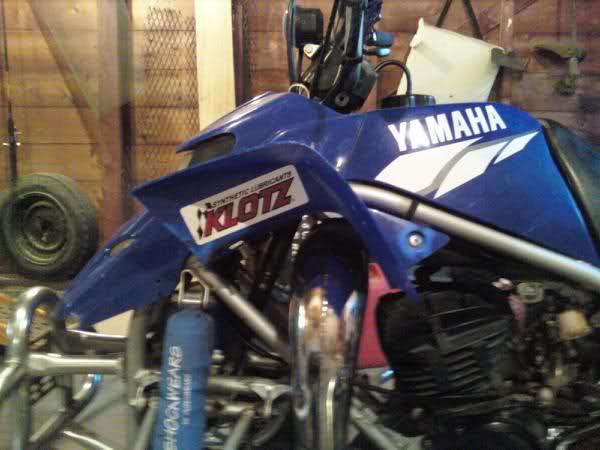

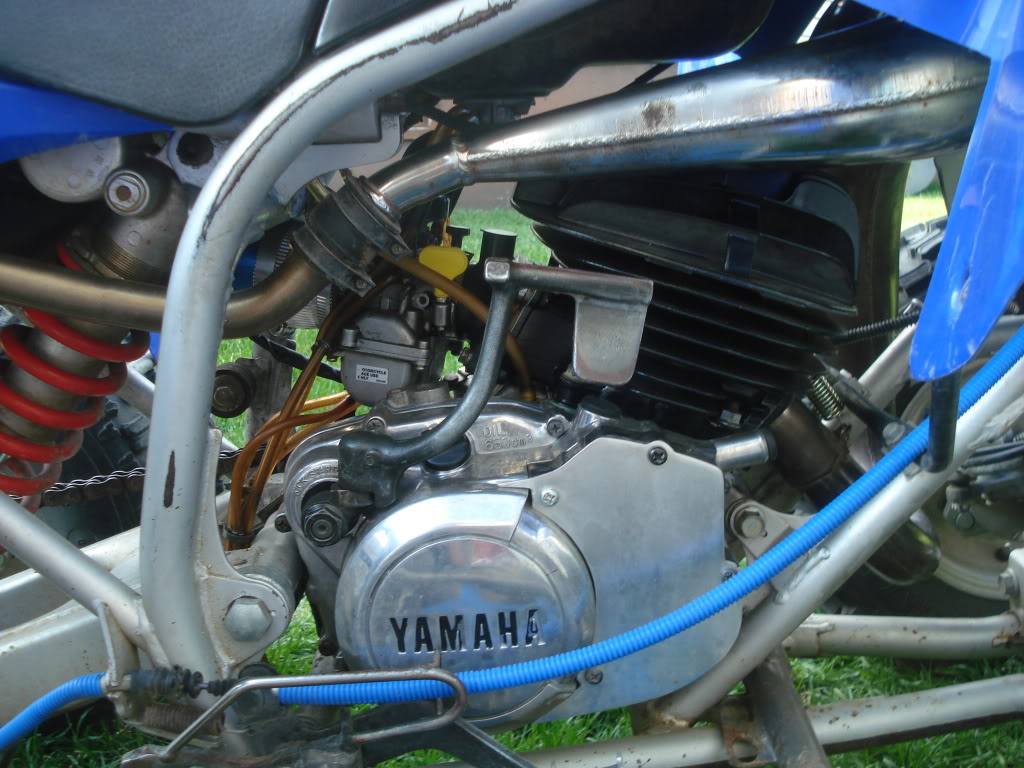

A Arms: Stock with skids
Swingarm: stock and +4 not on yet
Stabilizer: n/a
Axle: stock
Carrier:stock
Hubs F|R: stock
Bars: Moose racing
Throttle/Clutch Lever: motion pro
Grips: pillowtops
NerfsG STEEL
Bumper: BlingStar
Grab Bar: Custom bent
Front Shocks:Progressive 512's
Rear Shock: honda 400ex
Brake Lines: NEW!
Rotors F|R: stock
Rims F|R: ITP T9's Chrome
Tires F|R: Kenda dominators
Body:
Frame:Stock
Plastic:Raptor 700 rear, maier race front fenders
Handguards: Acerbis mx
Bar Pad: Moose
Fuel Tank: stock
Cylinder|Head: 240 Cylinder Trail Ported, Head milled 0.020" and redesighned
Bore & Stroke: 72mm/stock
Carburetor:Keihin PWK airstryker
Air Filter|Box:Custom box, Custom outerwears lid, K&N with Precharger
Pipe|Silencer: fmf gold series/Procircuit silencer
Clutch|Plates: Stock
Gearing F|R: 14/39
Cooling: Air scoops
Other:Trail tech vapor, Skid plates all around, 03+ hood and light, +3" spacers.

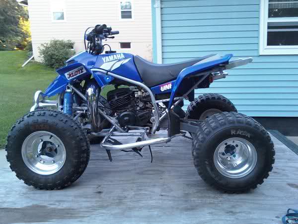

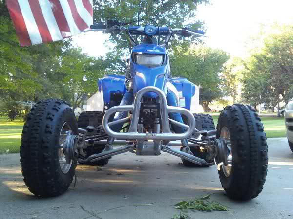

1. A Arms: stock
2. Swingarm: stock
3. Steering Stem: stock
4. Stabilizer:stock
5. Axle: stock
6. Carrier:stock
7. Locknut: stock
8. Hubs F|R:stock
9. Bars: stock
10. Throttle/Clutch Lever:stock
11. Grips: stock
12. Nerfs: stock
13. Bumper: stock
14. Grab Bar: CUSTOM
15. Front Shocks: banshee
16. Rear Shock: 250r
17. Brake Lines: stock
18. Rotors F|R: stock
19. Rims F|R: stock
20. Tires F|R:stock | RAZRS
Body:
1. Frame: stock
2. Plastic: stock
3. Graphics|Seat Cover: two-tone blue/black
4. Number Backgrounds: stock
5. Handguards: stock
6. Bar Pad:stock
7. Fuel Tank: stock
1. Cylinder|Head: stock
2. Bore & Stroke:stock
3. Displacement: stock
4. Cam: ....
5. Carburetor: stock
6. Air Filter|Box: K&N | stock
7. Pipe|Silencer: Pro Circuit
8. Clutch|Plates: stock
9. Gearing F|R: 13/40
10. CDI|Killswitch: stock
11. Cooling: Fresh Canadian Air
12. Other: Trailtech Vapor
