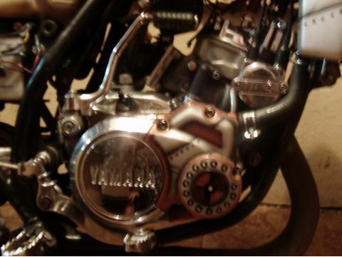

Still have some machining to do. Also waiting for my servo motor to come in, and figuring out how to wire the E-fan. Haven't started diss. the engine yet. I'm going all out with it, not going to sell the blaster anyways.
Here's some pics
sh*t!... Examined and cleaned the cylinder, powervalve and the other parts.
Sleeve is slightly cracked!!X(
Here's some pics
