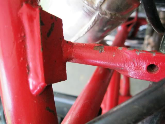

Got a question, how does my welding look? I've not been doing it but for about a yr. Think it's up to snuff for fabbing up my own parts or should I get some help from a engineering friend? All the gussets, custom fender mount, cdi mount, etc was welded by me. Thanks guys.
the welds look a little big, probably just need a little more heat. i think i'm going to have to get the hook up on some of those DT parts....

Blaster and DT use the same sleeve. Got a NOS wiseco from a guy on ebay for $55, 66mm. YFS200 and DT200R use the same sleeve. I'll get pics if someone wants me to back it up. lol Thanks for the reply on the welding, yeah I needed that constructive criticism. I'll try to adjust it, and post some pics when I start hacking up the swinger.

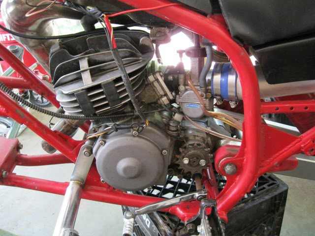

so What happened to this project? I was reading to see how you did your radiator but the thread stops. did the project? I just imported an entire Yamaha DT200 bike and I have already swapped the blaster engine into the bike with some modification and it works great! I have The DT motor mocked up in the blaster as well as the exhaust and suspension so I can see where i want to mount a radiator but I havent been sure on what to do. I am starting with trying to mount a 2001 YZF250F twin split rad but it is really close to suspension and exhaust. PUT MORE UP!!! inquiring minds want to know. if not im gonna beat you to the punch and have mine posted before yours is done!! LOL!!!I:I

I'm using a Kawasaki Ninja Radiator, prolly gonna swap that to a RZ350 rad or 86 ATC250R rad... doesn't seem large enough and I have pipe clearance issues as well. It does run, but I only have a rear brake so I've still got some work to do, jetting etc. Awesome you've done the swap? Is it an 84-88 DT200R or a WR200R engine?
i just finished this swap to my blaster took 2 days mounted rad and just used a blaster bottem end ( way better) dts use thinner shafts in the tranny with extra load they can and have broke. i dident swap the harness with my bike, This swap also gives u the chance to run a boost bottle most people forget that. after motor was complete i tryed it with the my blaster origional carb set up (270 main) and without the powervalve lost mid range power drastically but let me tell you EXPLOSIVE powerband. i used a 1984 dt motor and the primary is the same as the blaster??? aswell as the dt motor i used dident have a balancer in it. the hardest part with mounting the dts bottem end is the back engine mount is smaller with needs a tricky drill out to fit it.

The only reason this thread has dragged out is because of funding problems and time problems. I was finishing my undergraduate degree in Mechanical engineering during alot of it, and had lots of other odds and ends to tie up in other areas of my life. once I got down to it, it was a simple swap... I ran it two times and then decided to fool around with some other things on the quad/engine, and one thing led to another and now I've got a quad in parts and no time to finish it until next month. I still have some wiring issues to sort out, but it worked(pv that is). This wkend I'm sending pics to a friend and I'll post them on here for everyone to see. Also to make matters worse I'm training for dirtbike mx season in my spare time.
