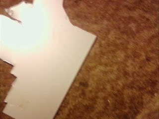

i made a skid plate out of some material i got from a friends dad. It was prob 1mm aluminum covering lil over a quarter inch peice of hard rubber/plastic pics in a few
heres pics
worked great tell it caught when i pushed it off the trailor
