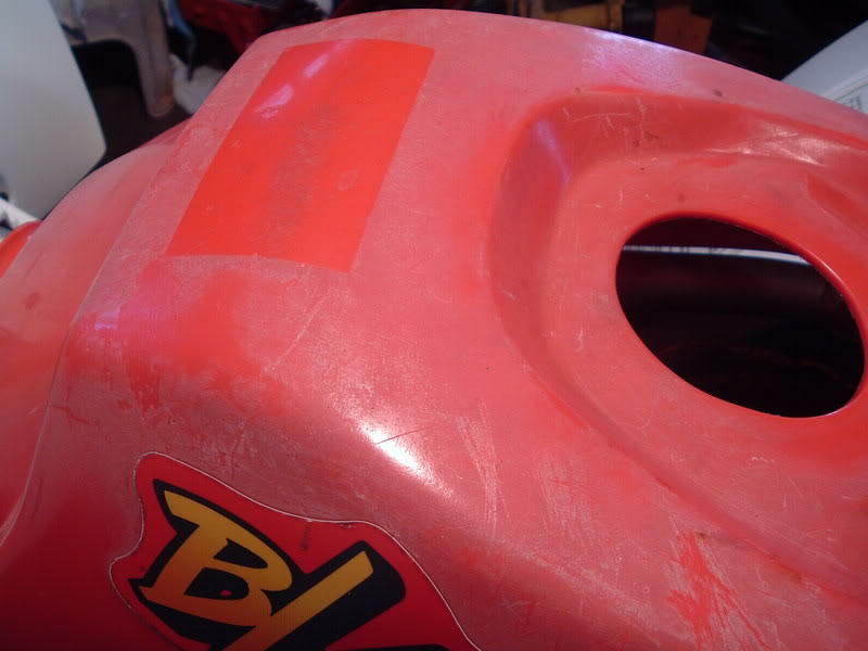

Hi guys, I've been looking at restoring my plastics. Has anyone tried a wet sand and buff? I've considered paint but, I'd rather try getting back the original finish first. I was thinking maybe shave the big stuff with a razor blade, then a 800,1000, then 1500 grit and buff. I don't have much experiance with plastic, just paint. Any thoughts?

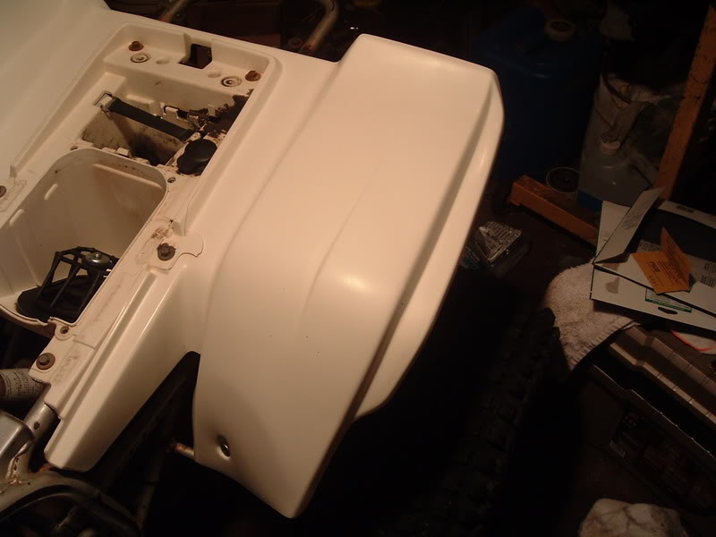

I think you can use a heat gun to make them shiny again. Just dont stay in one place too long or you will melt them. Mine weren't that bad so I just used rubbing compound and my 7" buffer and they look great.

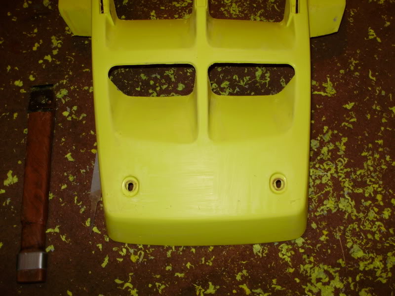

If your plastics are really bad the razor blade scrape works pretty good. Just make sure you hold it at an angle and scrape all they way to the edge of the fender. Don't stop in the middle or you will leave a gouge and have to do more sanding.

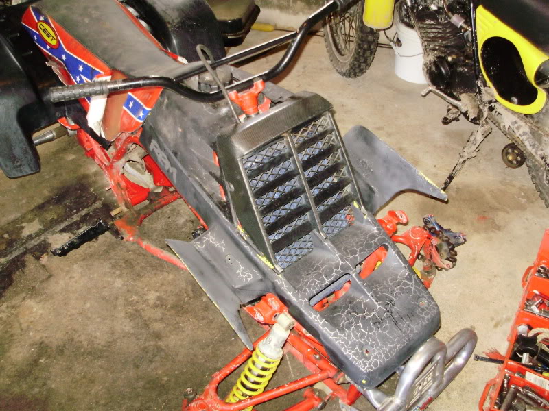

Well I've gotton over spray and grime off with a solvent cleaner and run the buffer over them so far, andd they look alot better. I'm experimenting on my blue plastics because I prefer the black and red I already have. I'm a little scared to wet sand them, but I'm going to give it a shot. Then try the mop and glo. Thanks for the input guys!
There are alot of different ways.
The sand and buff method is the hardest but if you do it right it's the most durable because being there is no finish theres no worries about scratches.
All work great if your willing to put the time in.
Here's the mop and glo method.
Here's the sand and buff method.
Here's the scrape, sand, paint method.

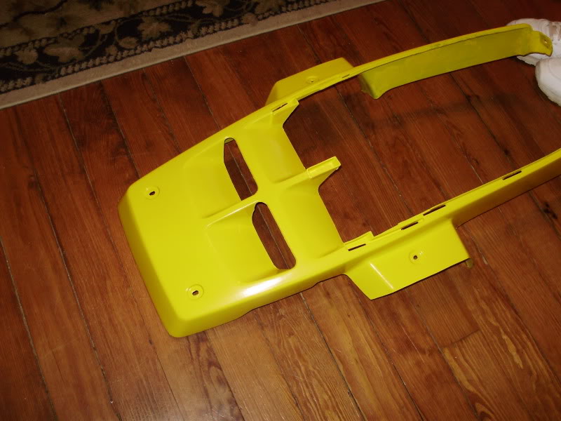

i painted my white plastics with white krylon fusion, looks brand freeking new hahaha I:I I:I
While I haven't used it on my plastics, I have used Fusion before on plastic and it is good stuff and I've heard others with success with it. Just scuff the surface and paint.
What I have done though is taken a powered car buffer with a coarse rag attachment on low speed and scuffed the whole plastic, then put on a less coarse attachment and got it to a near polish and took a heat gun to it and it came out just like new.

Wow, the mop and glo seems to really bring back the darker colored pieces. I'm gonna try a DA with some fine grit on some of the deeper scratches. Your input has helped guys, I'm definitly working off your ideas. I'll hit some of the discolored from stress areas with the heat gun. I'd like to get some crappier pieces and try paint. I'd like to have a set of satin black to put on a gloss colored frame for a murdered out look. Any body try vinyl covering their plastics?
