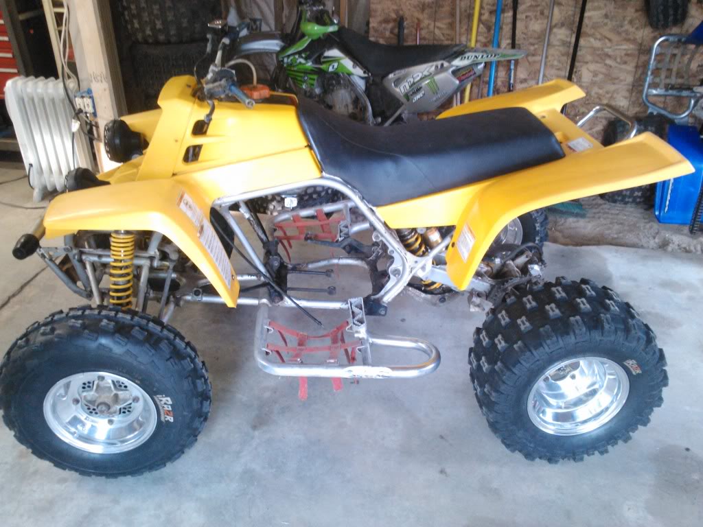

Waiting on parts. When I get my chariot impeller and do the plexiglas on the clutch cover I can get the bottom end finished up. Then I should have my cylinders back from KOR. My plastics are pretty faded. I might paint them yellow and do some cool designs on it.
Blue is a little to plain for me. I am definetly going to keep it yellow and black. I might try to shine up the plastics and put a decal kit on it. Or I might paint it. Not sure yet.
I don't think I'm going to paint the frame. I didn't paint or PC the frame on my blaster either. I know it looks good, but I don't want a trailer queen. I try to focus more performance than looks. I will probably get bored and tear both of them down and have the frames PC'd.

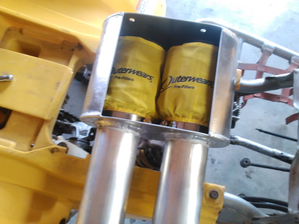

Cfm airbox, k&n filters, and outerwears came in. Put it together and just set it in there.

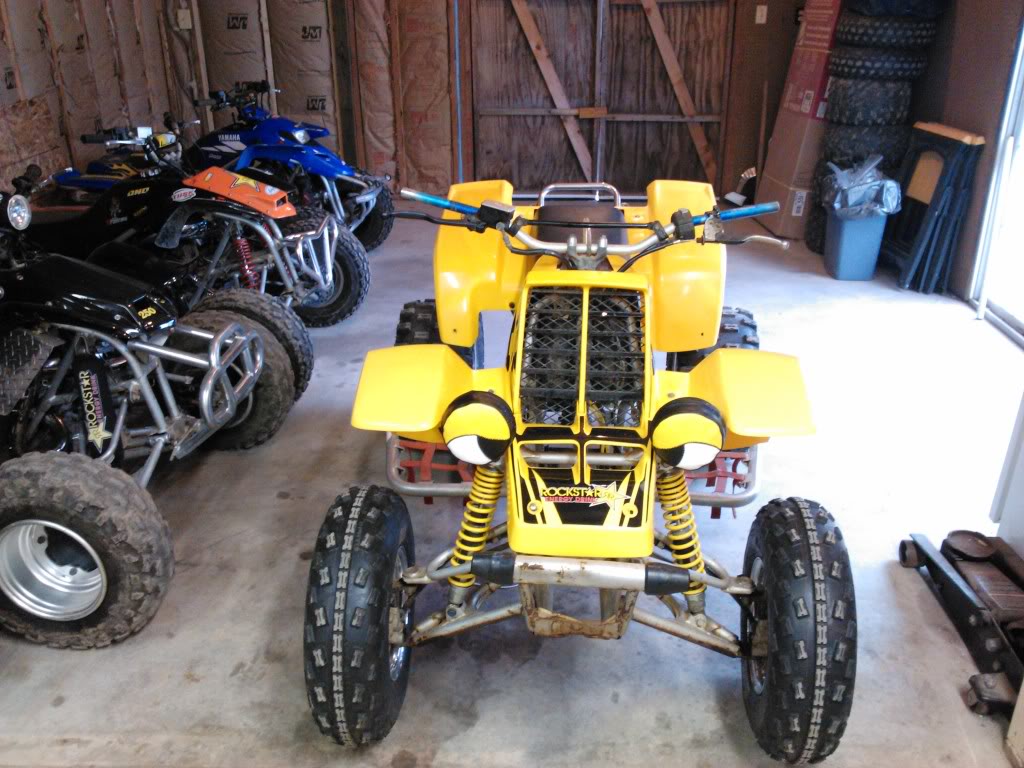

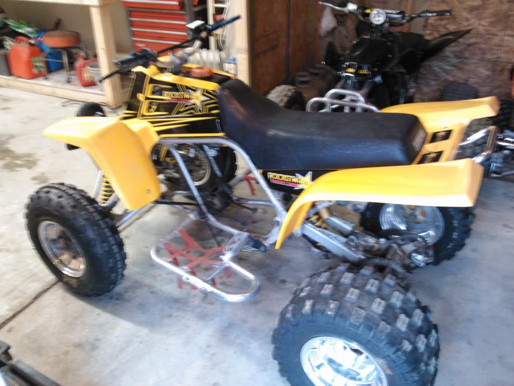

Graphics, seat cover, and the stuff to renew the plastics came in the mail. I will be doing them tomorrow and taking pictures.
The orange one isn't mine. The rockstar shock covers are going on the banshee. The black blaster is getting retro Yamaha graphics.
