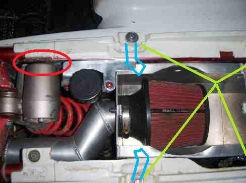

but the rezzie is offset to the kicker side, requiring the front tab of the rear fender and some of the plastic itself to be cut out for it to fit.
tab removed is circled in red here.........................
