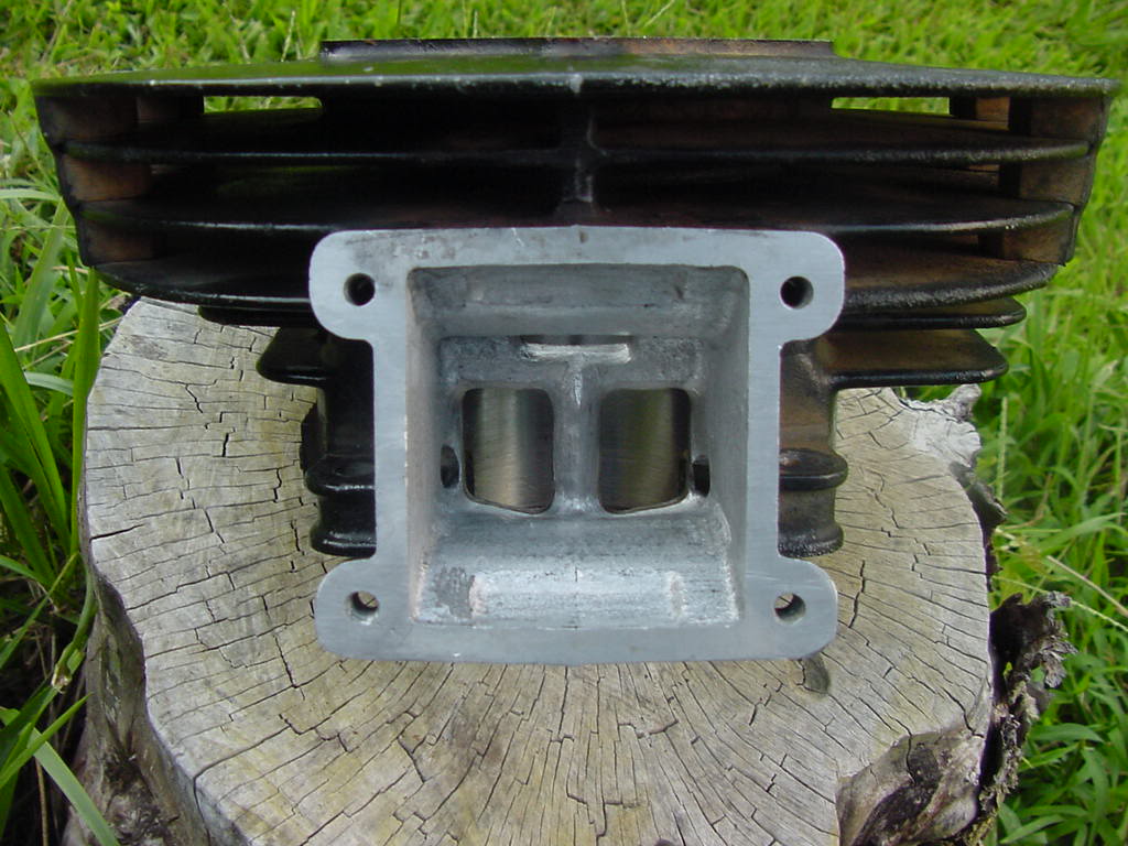

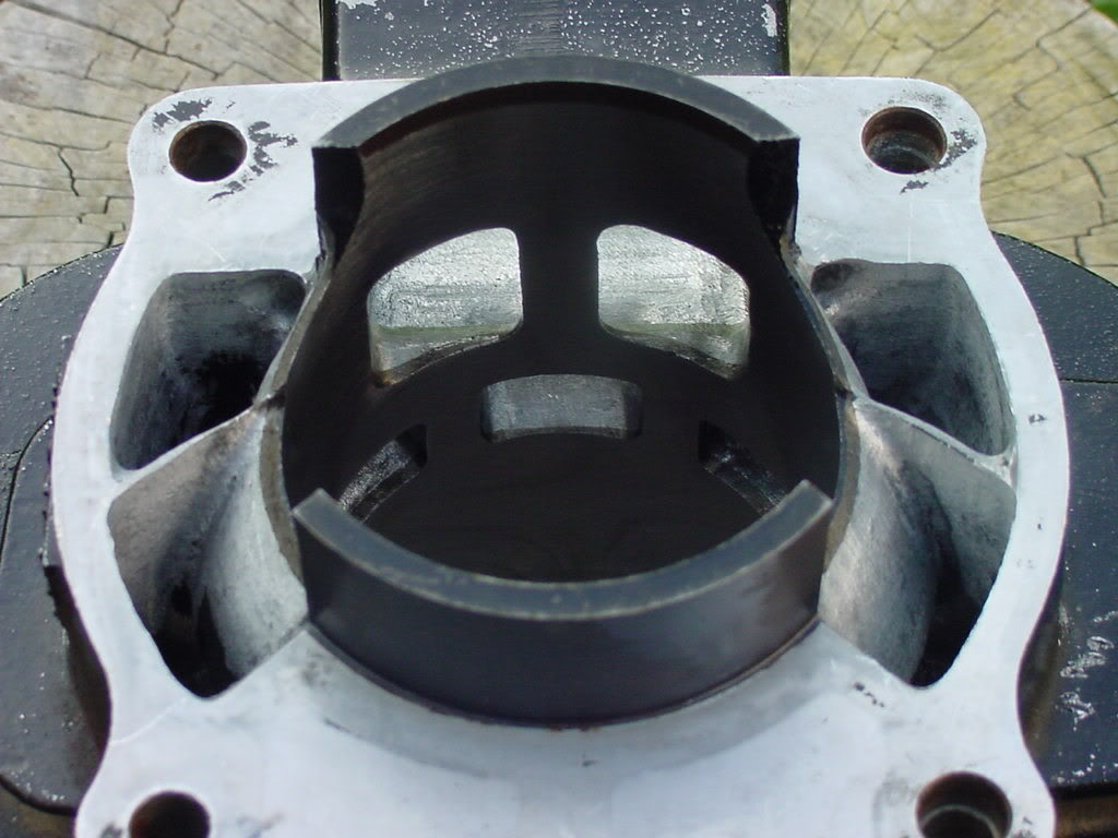

I'll post pics of the cylinder and head tonight after I get done lapping the mating surface of the cylinder to head for all to see. My wife is at school tonight so it won't make it in the mail today but if I get all of the lapping and cleaning done it will probably be mailed out tomorrow.
It should be a REAL strong midrange with enough grunt to get some holeshots. Emphasis is on midrange power for coming out of corners and getting into those jumps with enough speed. Should be a real stout engine!
If the above is Q10s head and jug, he is going to need a few trips to the Gym to pump up his muscles.:D
The young guy is going to get his arms torn off.:o
The above is QR10's new cylinder that will hit the mail this week. I set it up extra special for a budding MX'r and am taking his cylinder in exchange for that ^^^^^ one. :D
:o :o :o :o :o OMG! THAT IS AN INSANE PORT AND HEAD! OMG...... brb ima do a few hundred pushups!
