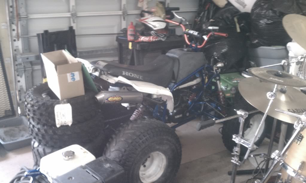

So I picked up this '98 Blasty on Thursday for 600 bucks....it's not in terrible shape but definately needs some work. I bought new tires, handlebars, and an FMF Fatty pipe with a TC2 silencer on friday.

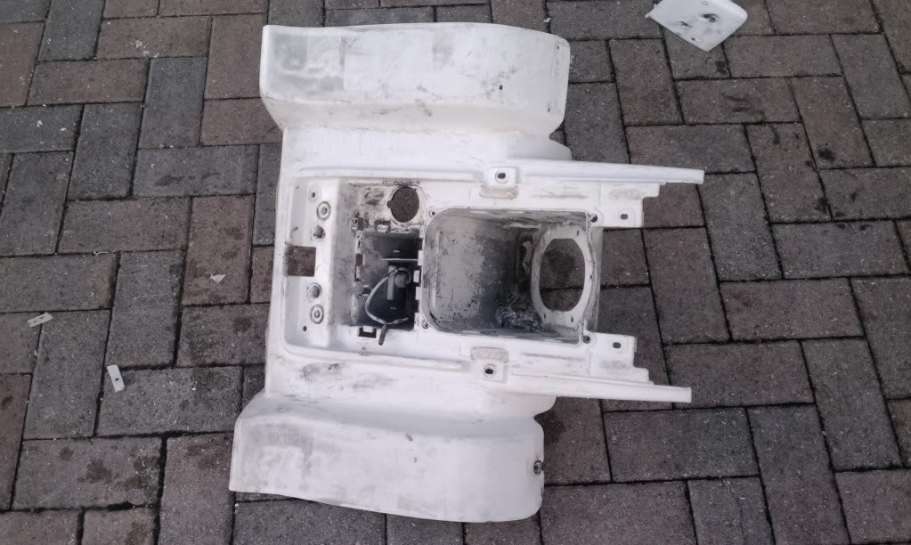

Chopped the rear fenders as they were in really rough shape along the edges.
Stripped all the jacked up pearl while paint off of all the plastics, took my time sanding and sanding and more sanding,. then whet sanding with 2k grit to make everything extra smooth. Started painting them my favorite color....Flat Black!!! (this is why all the prep work...Flat black shows EVERYTHING!!!) I still have the rear fenders paint tomorrow but got the sanding out of the way at least.

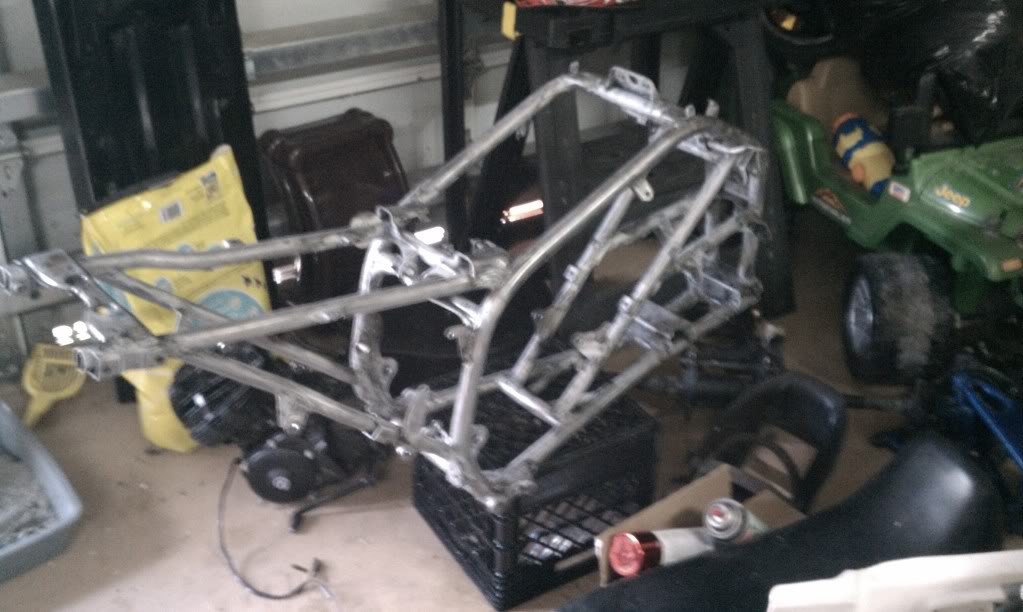

Thanks guys! I started using a wire wheel to strip the frame today and came to the conclusion that it was going to take FOREVER doing it that way. Plus these frames just have too many hard to reach places. I was never going to get to them all doing it by hand....sooo, I picked up 100 lbs of blast media and fired up the portable sand blaster. Took me 2 hours to do the strip it clean. Tomorrow I have to blast the A-arms, swing ARM and steering tube, then I can finish painting everything. Red frame, flat black plastics, and white accents....very rat-roddish. On another note I was able to brush all the used sand into the gaps between the pagers in my driveway! 2 for 1 baby!

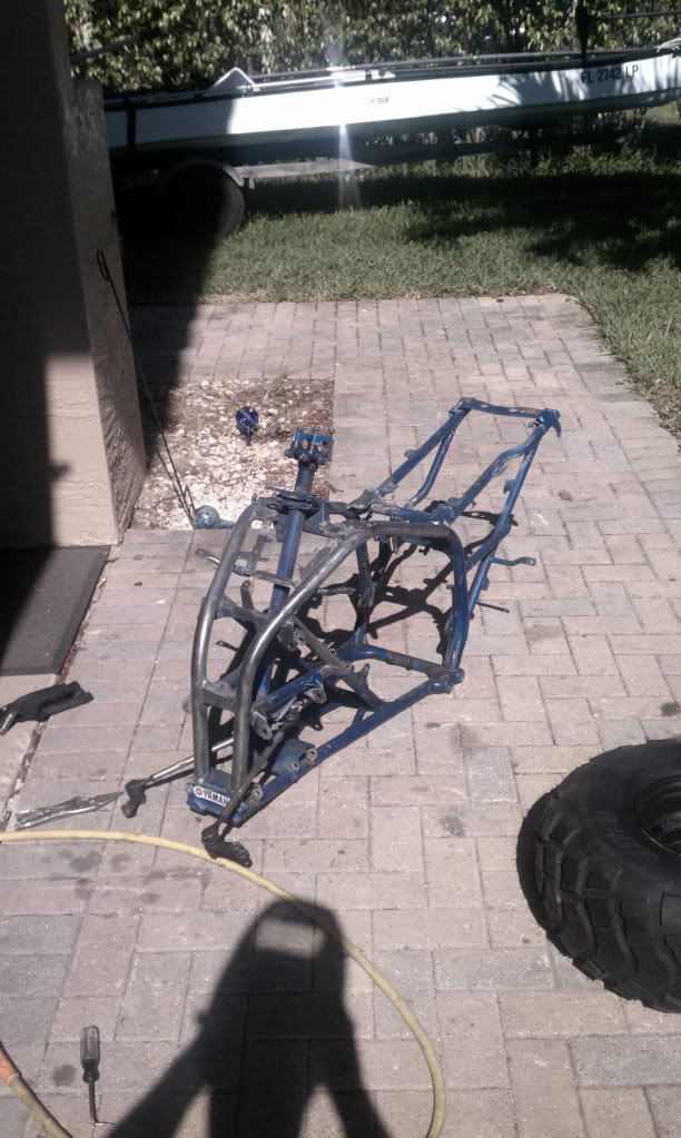

here's yesterdays sandblast pic:
Where i was trying to wirewheel.
Post sandblast:
