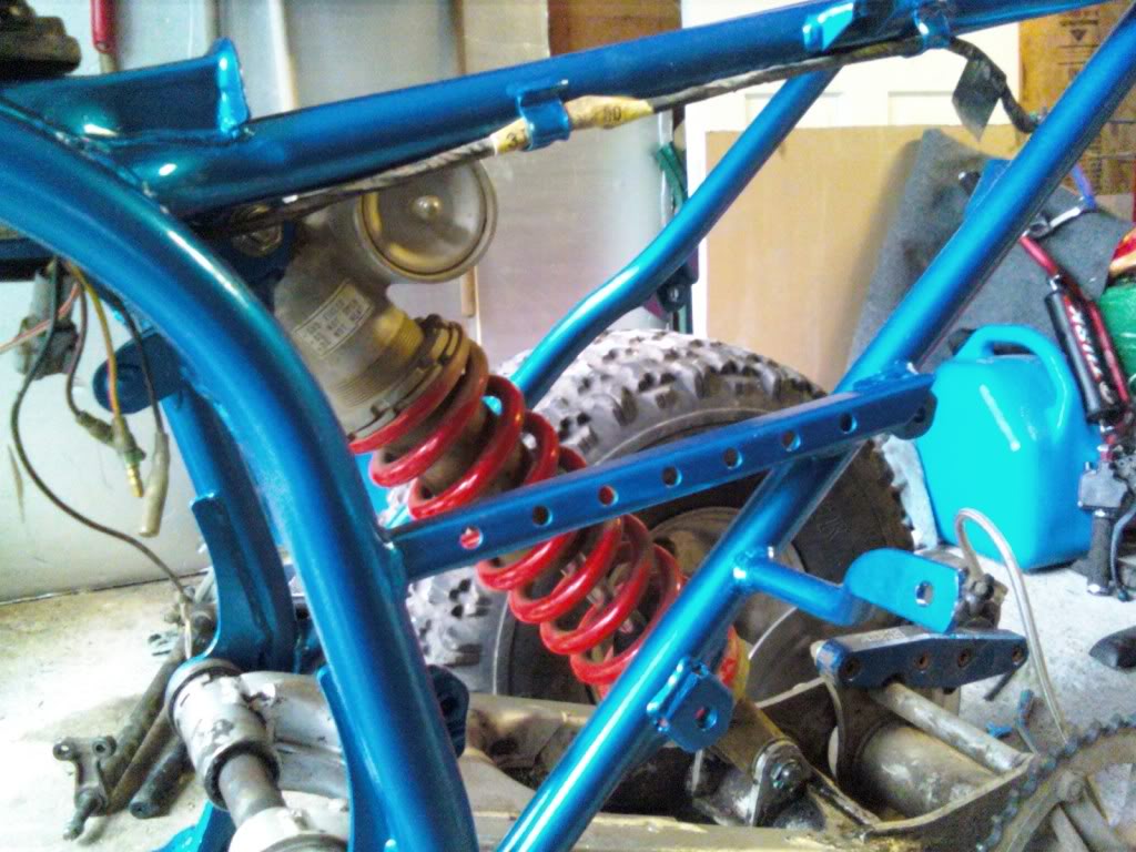

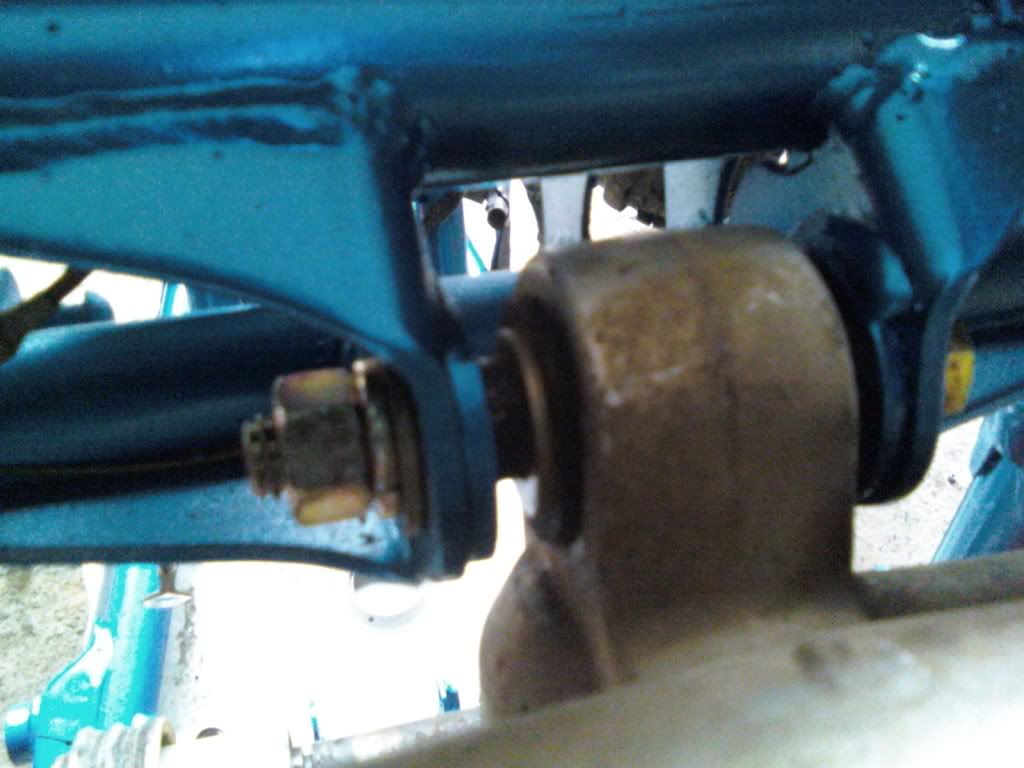

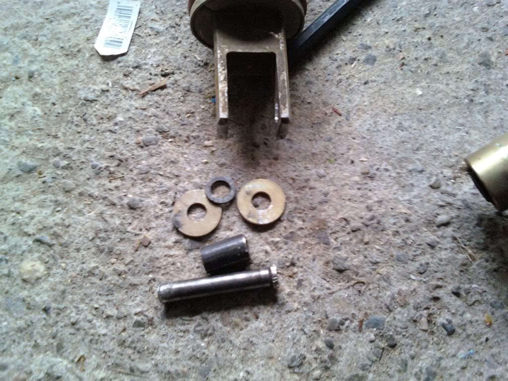

Another small update I installed my 400ex rear shock.

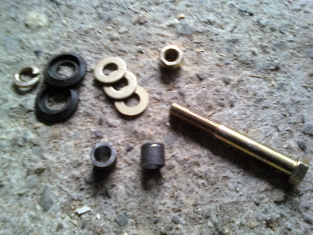

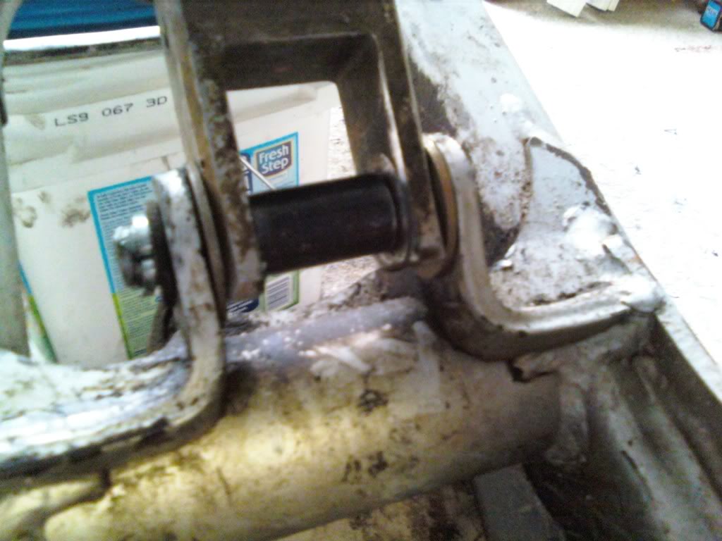

To mount the bottom I used the blasters stock pin and washer, 2 3/8 washers, and 3/8 black piping for the spacer. I had to drill the shock to fit the blaster stock pin.
To mount the top I used 3/8x3" Bolt, 1 nut, 3 washers, 1 lock washer, blaster upper shock bushings, and 1/4 black piping that i had to drill out to match the bolt. The 1/4 piping fit snug inside the frame mount holes, so there is very little play.

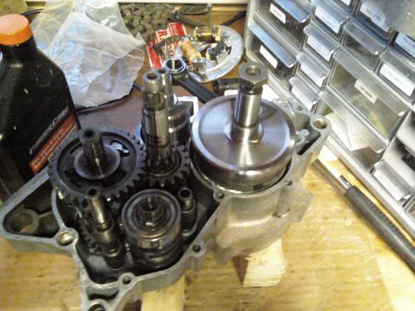

Well the motor is going back together now that i have all the parts. Im pretty sure i have the transmission in correctly, everything is turning smoothly.

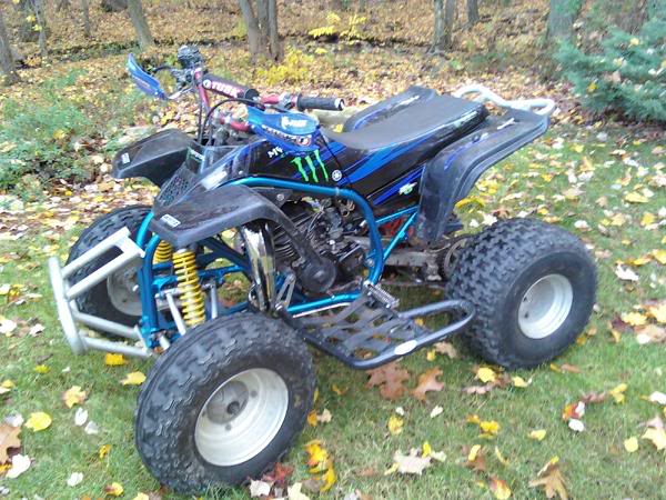

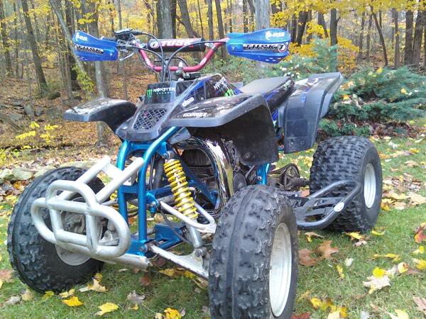

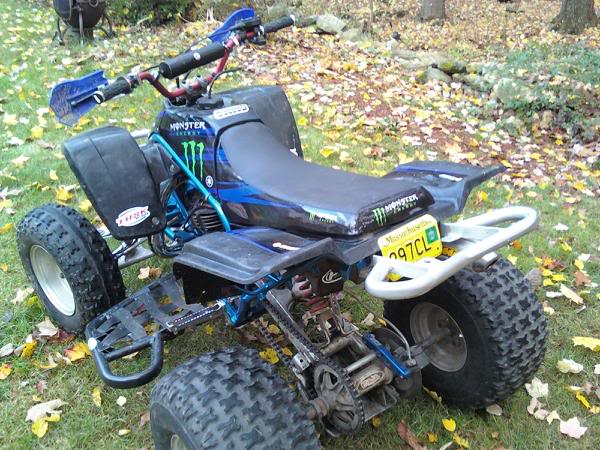

Well got it all together and started breaking her in today. She is running mint! I do have a couple issues, the kick start return spring is broken and the carb is poring gas out of the over flow tube. So i just need another day to fix those items and break her in completely.
