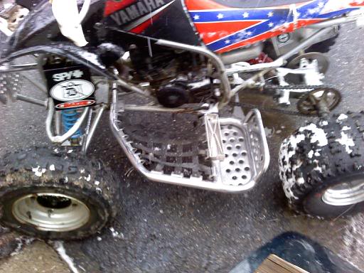

i have zuki ltz 400 pro armor, fat peg, nerfs with heelgaurds on my blaster
it took a very considerable amount of work to make them fit, but...i got them brand new for $125, so the extra effort was worth it
i had to cut out 5" of the outer rail, right in front of the footpeg, split and pound that 5" piece into each side for added strength, then reweld the aluminum
had to make round footpegs so the fat pegs could slide on and bolt thru
cut off the right front lower mount, and mount the left side under a longer lower a-arm bolt
trim the middle where they meet in front of the motor, and bolt thru both
weld rear upper mounts onto my frame for that mount on both sides
an extreme amount of work and custom fabbing, but well worth the effort to me, my feet feel like they are in an armor cage and very well protected

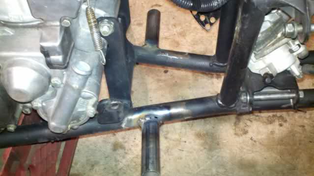

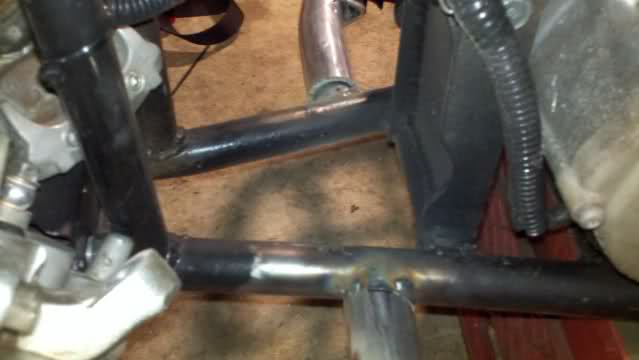

depending on which style u find you can use some from a 06 yfz 450. they will bolt up to the blaster peg and then all u would have to worry about is a front mount which should be easy by cutting the nerf at the frame and welding a tube on the frame for the front to slide on. mine are that way and its holding up great so far. here is a pic of the mount im talking about.
you can see in this pic where the nerfs are slid on those tubes, very easy to make.
