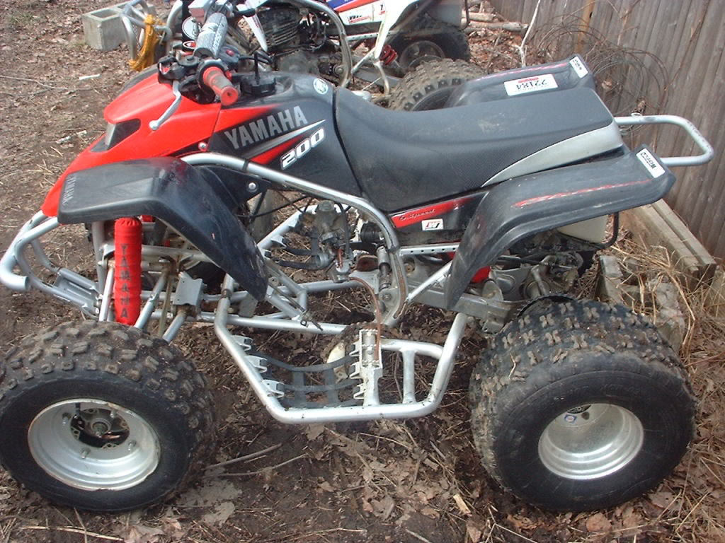

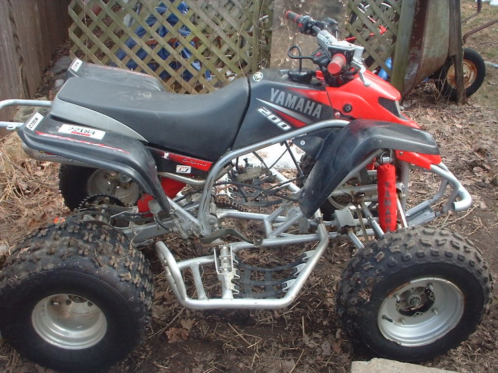

I just got a really good deal off ebay for a set of race lite nerfs with pegs.
However the good deal dont look so good because they either dont fit or I am missing something!!!
Can anyone with a set of these, please post a pic of the front mount area?
Thank You
there should be mounts around where the two sides meet in the front.. they should line up with the engine mounts
not these. they have a 2 pc bracket system from what I have seen is some not so close up pics. I need to figure out how to make this bracket if the ebay seller refuses the return which appears what he is doing.
Best i can do for ya man. hope it helps
you can just u-bolt them to the bottom rails, lots of older style nerfs mounted like that, just make sure to face the bolts upwards
Thanks everyone. i think I am just gonna have a tab welded to the nerf and use ubolts. Seems the easiest route. I appreciate the pics. I am still awaiting paypal/ebay to rule on it. Probably gonna have to make them work.
