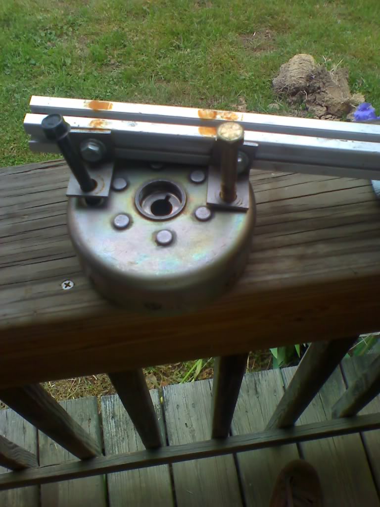

I made my own flywheel holder out of some stuff I had around the house. There not hard to make. Basically its just a long piece of metal with a couple holes in it to stick bolts through and into the 2 holes in the flywheel. They don't thread in, but they don't need to, all they do is stop it from turning. Another way is to rotate the crank till the piston is at BDC (bottom dead center) and then feed a small rope through the spark plug hole till you fill the cylinder with it, and that will prevent anything from turning. Then just pull the rope back out.

heres a pic of my flywheel holder
