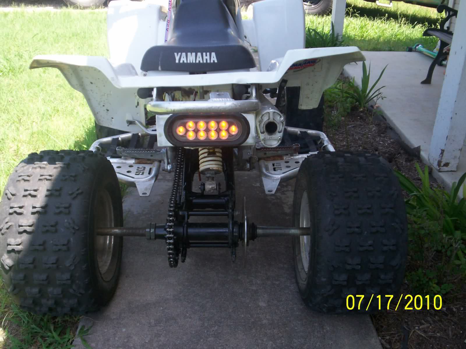

It is amazing the stuff you can sell on ebay! Good job on the lights Here is the one I built took like 15 minutes and an led light I had laying around.
I have switched it to red since I built this.
sweet light, bet that one will last longer than these lil cheapies i use ???
seeing as how it looks to be from a .................
Caterpillar
