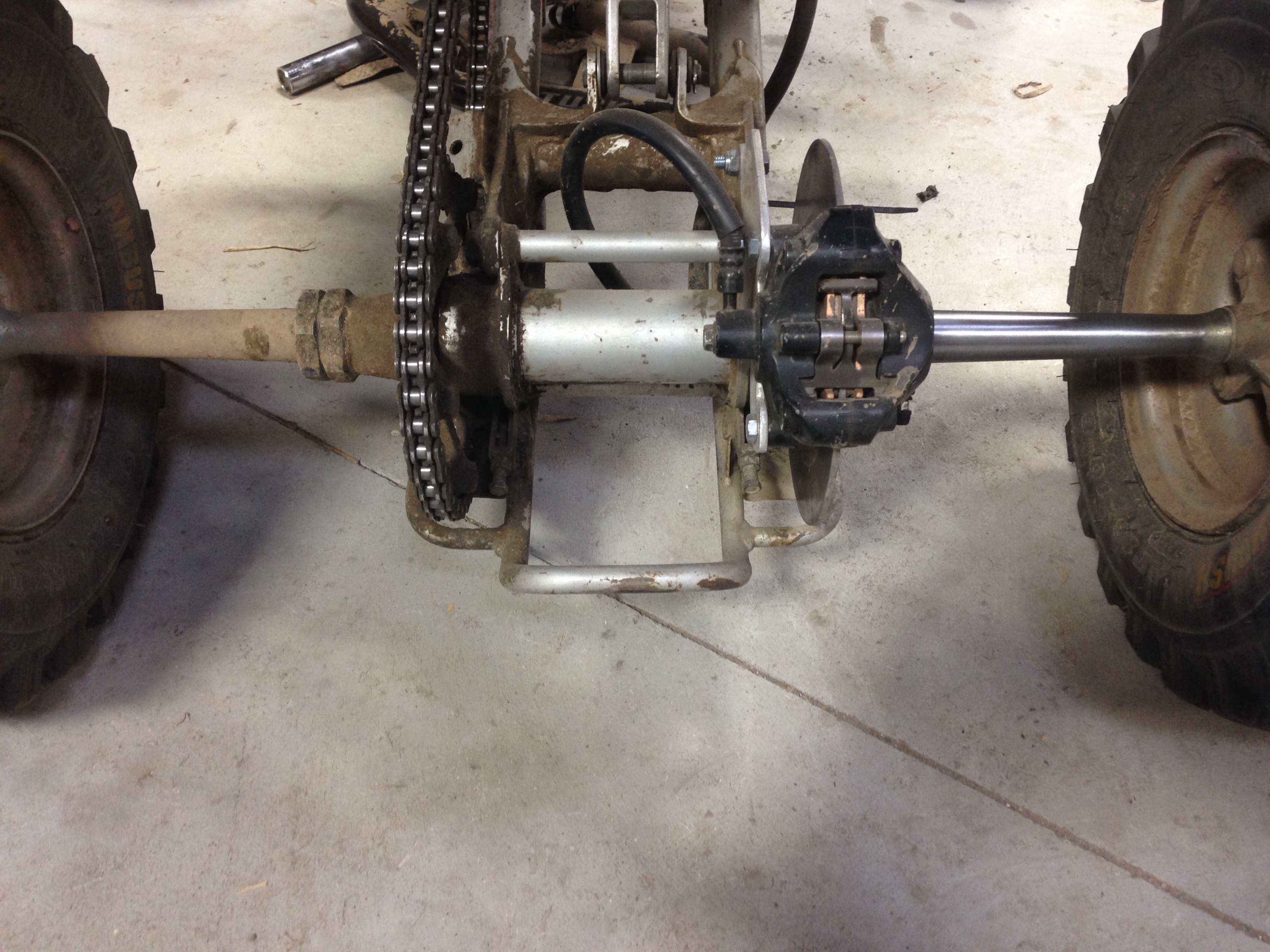

Just to clarify, you are moving your rear brake line right?! Cant leave it under the swinger!
yep /\
this.................
img_2854-jpg.22631
should be this............
be sure to ty-rap it in place so it doesn't flop around into the sprocket or brake disc

Its been fixed guys! Its an old pic and that wasn't thinking when I put it on the first time. Good catch tho!
