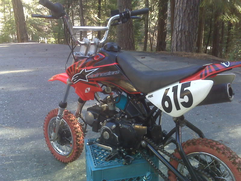

Here is my pit bike:
China frame/Swinger
Lifan 124cc engine Uni Air filter
Millville tires
Hydro front brakes
Tall seat
"tall bars" set up
the pic is missing the tall seat, lifan 124 engine and I have different numbers put on it now. Just to give you and idea of what you can build for less than $700
