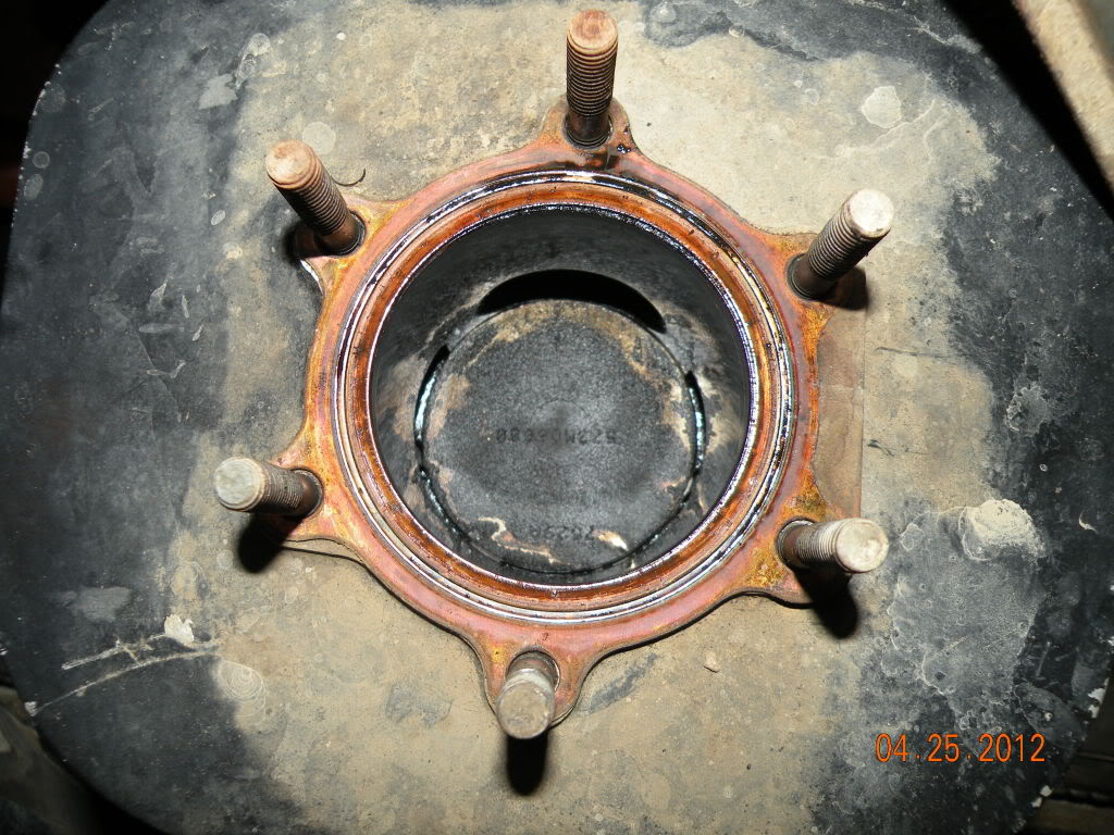

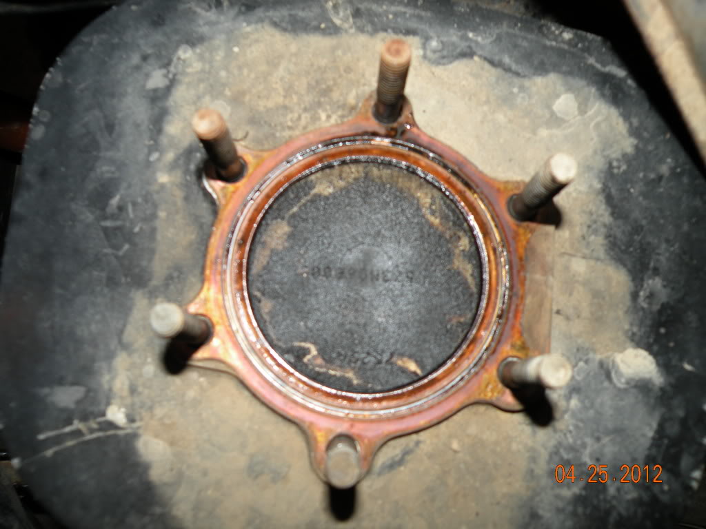

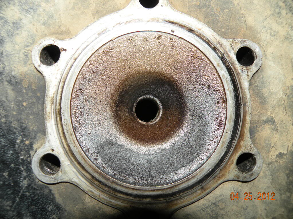

I took everything apart today, there isn't much cylinder damage from what i can see ( Only took the head off ) i'll just have to hone it a bit, but the top of the piston and the exhaust port is like almost black with what i think is just like burnt off carbon right? I think it's stock piston and bore, couldn't really tell the numbers off the top of the piston were dirty. I'm going to grab a manual and rebuild the top end soon. I'll get pictures up soon off how dirty it was.
I've never actually taken off a Cylinder head before, or even gotten pass the crank cases on a bike. So this will be my first rebuild, since i really can't afford to have someone do it for me. So any rebuild kit's you guys recommend, or anything you guys can recommend me will be greatly appreciated.
Yes if it's in spec for a stock bore after honing, But you need to know the bore diameter before you order so you get the right piston size.
The piston in it should have it's size stamped on top that should tell you the size bore spec to look for to go off of in mm.

Alright, i'll be sure to look at that when i do the full tare down.
But here are those nasty photos i was talking about.
The #'s next the intake side look to be the piston size? 75.25?
I'm just guessing at that but someone with more knowledge should know for sure. I just have a stock piston in mine and the part # includes the size.
I think this is stock. I didn't ask when i picked it up.
But i'm sure that after i clean up the piston i will be able to see what the number's read.
