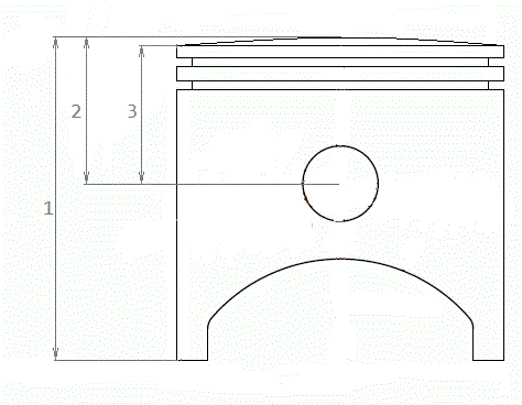

Hi All there :)
I am planing on using some Blaster engine parts but I need some measuremants
I would be very grateful if you can provide me with one :)
total piston height (from bottom of the piston to the centre of the dome
from the pin center to dome top
from the pin center to piston top (on the side of the piston)
If someone can provide me with this information I would be very happy
Thanks in advance
Well this is what i came up with, for a weisco forged 68mm piston:
total piston height (from bottom of the piston to the centre of the dome) 68mm
from the pin center to dome top 30mm
from the pin center to piston top (on the side of the piston) 29mm
The pioston height is the same as the width! 68mm
Sure do need a new digital set of calipers!
just to be sure you understood me correctly
(because of my bad English)
these are the measurements you gave me?
