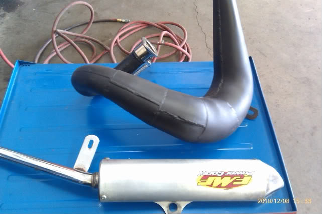

Pipe Brand And Name:fmf fatty
Estimated Price:300 ish
Your Engine Setup:stock with oversized carb
Your Location:so cal
Your jetting:
Overall Performance Of The Pipe: great low end and mid range
Overall Quality Of The Pipe: still clean after few years no problems very happy with purchase
