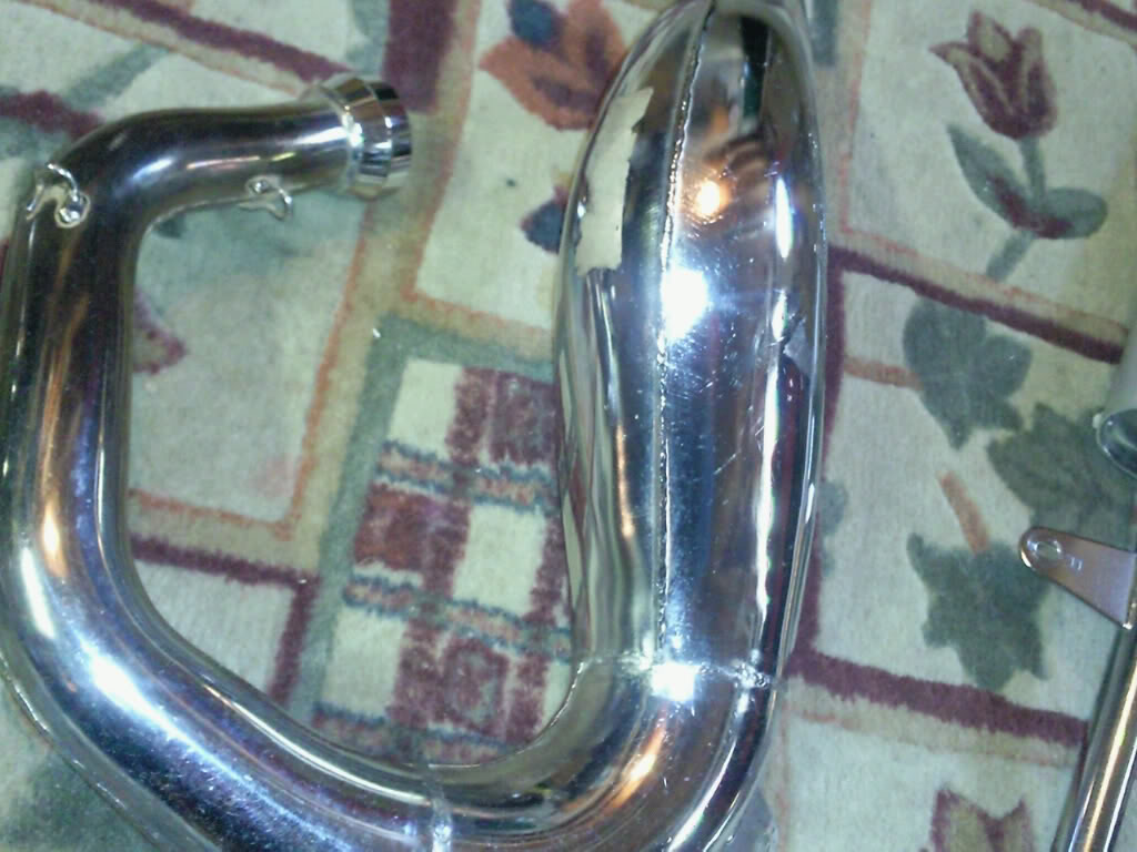

my pipe gasket it leaking pretty bad and unburned premix is dripping all over the motor... yuk, but anyways i was wondering id this would cause my machine to run lean, and make it idle irregularity ?
nope, the air is leaving the engine at that point, not gunna have much of an affect if any
wrong, the pipe plays a huge role in how a 2 stroke runs. sure the air is leaving, but the pipe "bounces" the air charge back to the cylinder to be burnt, that's why they're shaped the way they are.
get it sealed back up, but since you'll have it off anyway, i'd do a leakdown on it to see if anything else is going on as well.

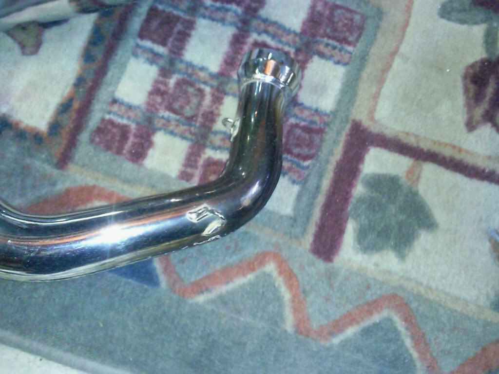

almost all pipes get a burning mark right there.
what kind of pipe is it?
an what does the spark plug look like after a plug chop? how about the results of a leakdown?
so i know its lean, im wonderng if the gasket will straiten it outi used a fresh plug and its a lil greyish
it is more a tarnish mark
chrome pipes get them really bad.
