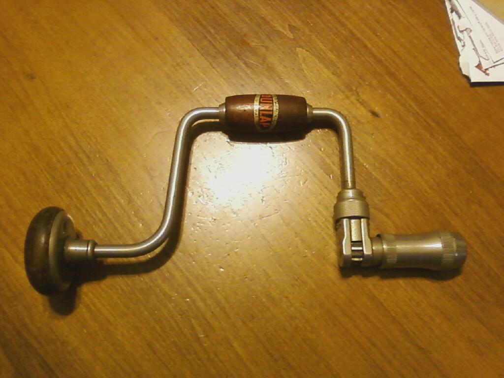

I used this tool i dont remember what it is called but here is a pic.. I just found the right size phillips bit, and then i made a box out of 2x4 that the case fit nice in snug in.
Put the 2x4 box on the ground with the case in it then get this tool in place and put ALL of your WEIGHT right over it and give it a BUMP!!! It will take less then 1/4 turn to get it LOOSE.
