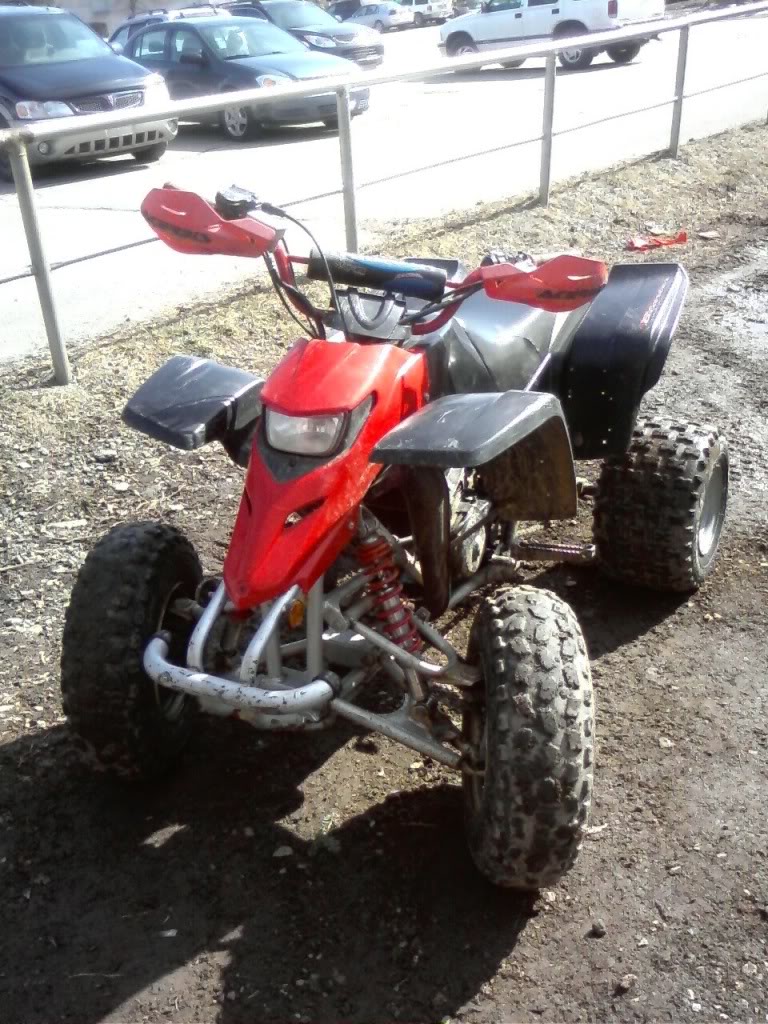

and update on blaster

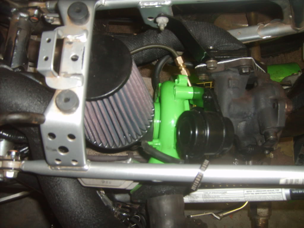

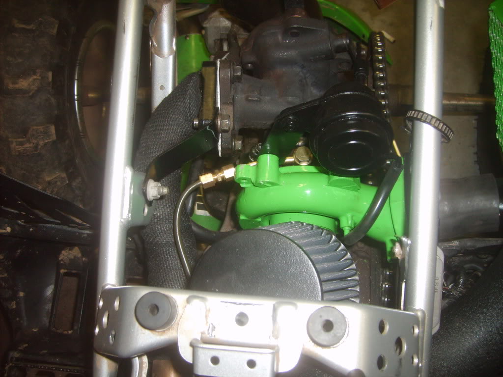

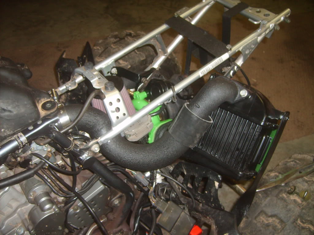

Turbocharged Arctic Cat DVX 400.
Big bore kit
Mikuni blow through carb
Mitsubishi TD04l turbocharger
K&N filter
Side mounted custom intercooler
2.5in chargepipes
Rising rate FPR
All fabbed, tuned, and powdercoated in house
Its pretty quick. Have not had it to the dyno yet but we are shooting for about 70 at the wheels at 6psi
Total cost of the build was about 300 bucks. We run an auto performance shop and had 99% of the stuff laying around.
Sure do!!Most of these were during the build so please excuse the fact that there are no plastics in the rear and the one "mock up" coupler on the intercooler pipe. It was replaced with the proper reducing coupler when it finally came in.
It was retarded with just a slip on, filter and jets. Now its just a total suicide machine. I seriously dont like to ride it. Thats why I bought my blaster to have a something a bit more fun and practical, not to mention dirt cheap to fix!!!
look like stock dsm stuff.. correct? looks to be stock talon/ eclipse side mount intercooler, and stock turbo.. uhh 13b? cant reember what stock was my talon had abig 16g on it..
Very similar! Its actually all Subaru OEM stuff. We run a shop selling Subie parts and building race prepped STi's and WRXs and have a ton of crap laying around. The intercooler is a resized WRX top mount. Its funny cause it uses all OEM subaru gaskets all the way from the turbo inlet/outlet all the way to the intercooler. =))
i hear ya man.. some times the fun factor is beter than brute power!!
hahahaha!! nice.. i was close i know mitzu and subie interchanged alot.. i called the dealer on a stock bov flange gasket and the mitzu dealer didnt have one so they told me to call subie.. and subie had what i needed...
