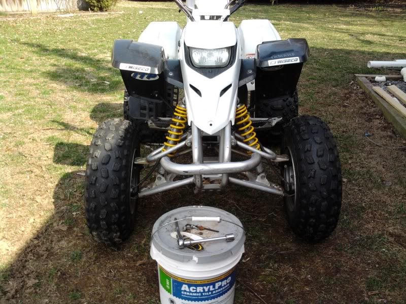

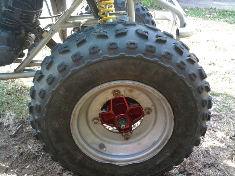

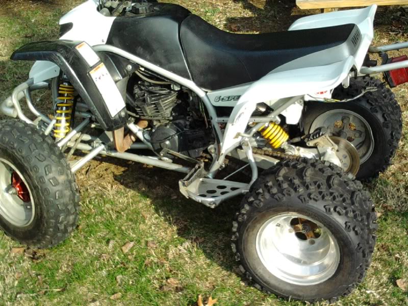

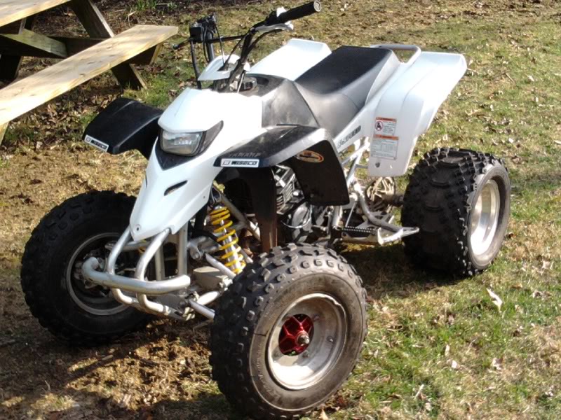

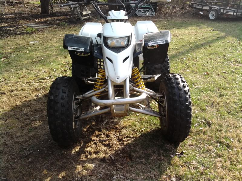

Got the normans installed and got some fresh pics of the blasty.
Before with modified warrior spindles (never again!)
after (new norman spindles great product these are great)
Can't wait to get a new exhaust this stocker is garbage lol
Looking to go all white with this I want to trade my black front fenders and tank cover for a white set.

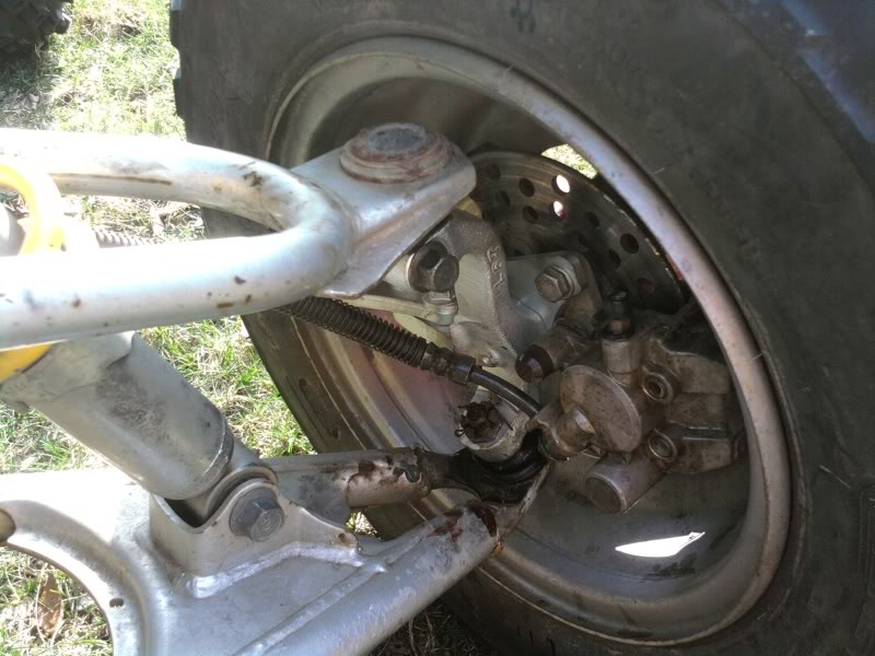

To have disk brakes. I was low on cash when I did it and had those laying around. I never got a chance to swap on the normans because it got stolen in aug of 09. I got it back in jan 2011 and ordered the norman spindles last week.
did anyone else have trouble getting the tierods out of the old spindles? just helped my friend put these on and we need 1 new tie rod end cause we never did get it out
i did. just smack the side of the spindle, not the tie rod, and it will fall out. smack it with a hammer on one side, then the other until it falls out. i was hitting my tierod and then i figured out to hit the spindle instead of the tie rod.
We did that. I beat tht spindle to hell and back. Then when that wasnt working we put a nut on it to protect the threads and hit the nut so hard that we screwed up the threads in the nut and on the tierod. He is just getting a new tierod end
