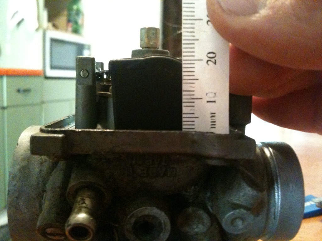

heres what i meant about measuring...help make it simpler for you. this is the proper float height and where to measure from and what your looking for... note; this float is set at 21mm
in the pic are you eyeballing it? also i checked his vids he has no float set video, but how do you move the float up or down to chage the float height, i downloaded A mm ruler! also is 21 mm the correct float height?
Yes, looking at how I took the picture shows you how to eyeball it level. See how the float is at 21mm? To raise or lower it you must move the (tang) up or down. Thats the part that blaaster showed you in the other pic he posted Just look at the pic, if I needed to Raise my float, I would bend the tab up, making the float go down in the carb. If I wanted to lower my float, I'd bend the tang down, making the float sit hIgher up in the carb. See? Did you find them vids???
actually float is corect i just checked again, could the main jet being to rich cause it not to idle and for air and idle screw not to work?? EDIT! I think the float is actually a mm to high so should i move the tang down? and how do i bend the tang????????
