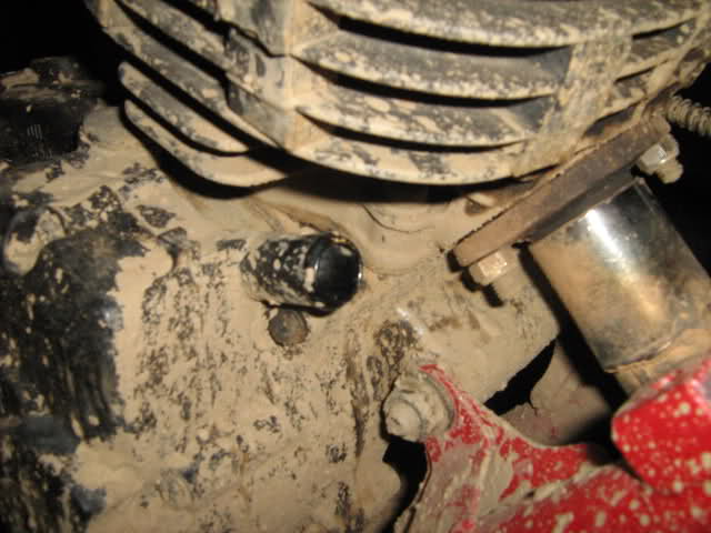

Ok....new theory...what is the metal tube that is part of the cases of the motor....on the end should there be a rubber plug??? Cause the guy at the shop didnt put that back in....does that lead into the cases???
are you talking about the tubes on the oil injection cover???? if so with those not being plugged or hooked up to the oiler it can cause serious engine damage
Here is a picture of it(its on the engine btw) there was a rubber cap or sumthin in this hole before and im wondering if that tube goes right into the motor....cause it was muddy at the trach and sh*t def. coulda got in there!!!! Heres a picture of it!
no man thats just an old cast left over from the dt200 motor, it is sealed so nothing will get in yor motor, dont know why they continued to make them with that on there
Hmmmmmm..... back to the drawing board i guess....what could have happened then?? The only thing i can think of is a blown gasket or one of the reeds broke or sumthin....???
