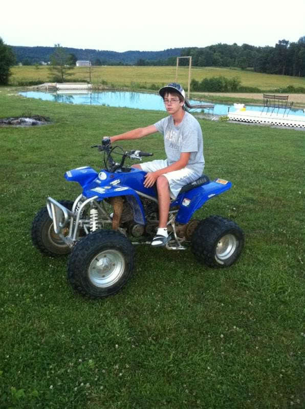

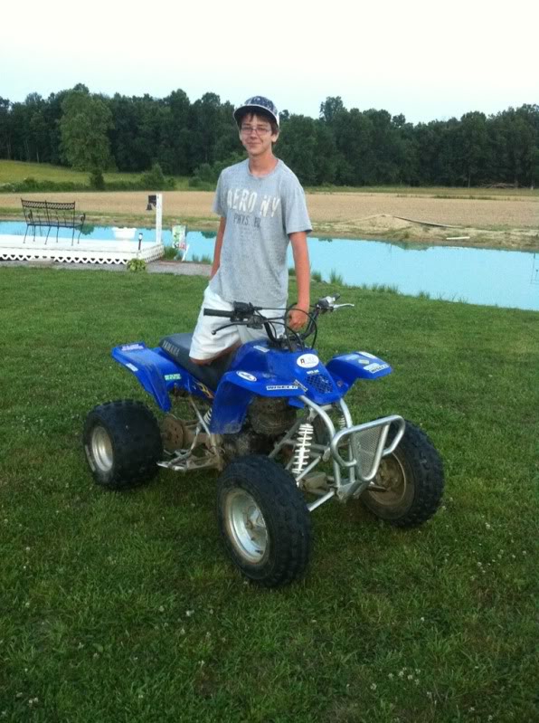

Hi guys! My 14 year old Son just got a 2000 Blaster last night and we have been working on getting it running today.
I have been looking at the downloadable manual and it shows the standard plug as being the NGK B8ES (If I remember correctly)....The plug in the bike now is a NGK R BCPR5ES11??? Is this even the correct plug? I am pretty sure it is fouled... I am planning on buying a new plug tomorrow and would like to know what plug is best...Not looking for racing quality, just something that will be dependable!
Also the baffle is missing from the spark arrestor and will it be OK to try and get the bike running without it or will it not have the proper back pressure?
It has a DG front pipe but the factory stock muffler...Is there a cheap spark arrestor that has good quality? This is my Son's project so he is mowing lawns and doing home projects to fund it...
The air filter is missing and we are planning on getting a replacement for that but can we at least try to get it running without it? We certainly don't want to hurt anything just trying to get it running...
The stator cover is missing so I am hoping I can buy that reasonably cheap? How do you know for certain if the stator is working correctly?
We pulled it down the road with my utility ATV and it would hit a few times but not stay running...I'm pretty sure the carb is missing some screws or jets as it has several missing holes...
The oil tank has been removed so I am assuming the previous owners have mixed the oil and gas and plugged off the automatic oiler lines? What lines should I be looking for exactly? Is the 32:1 mix my local shop suggested going to be correct? Will it hurt the bike running this way?
I am also missing the complete rear brake assembly if anyone has a parts bike they would sell this from?
Please email me direct at torinocobra429scj@yahoo.com if you have parts for sale or can direct me in the right direction! Thanks
Here are a few pics:

bike looks ok, but it seems like the previous owner was a bit of a ricer. you have anice project on your hands, i would suggest that it probably will need some engine work but a compression test and a leak test are you best tools to test the condition of the motor.
