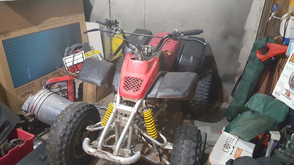

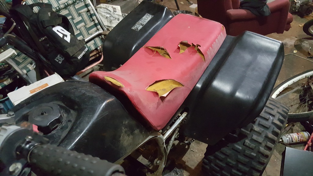

Hi, I'm charlie. I'm a gear head and usually I stick to things with three wheels, but I ended up bringing this home. I think it's a 97, butI'm not 100% sure
the plastics are perfect and apparently they're an after market brand called meiers
I've got everything except a motor for it, which i can get a stock 200 for 80$ but there's no fun in Stock. I can get a yz250 motor for roughly the same price, and I'd like to install that. I'll do a search on here to learn more about that. Also, what's this big weird thing on top of the carb?
I'm looking forward to learning. Charlie

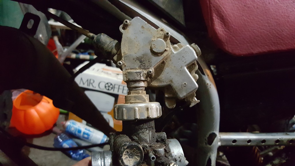

That's the TORS unit. It's a throttle override if the throttle was to get stuck. Everyone eliminates them due to them being faulty. Won't have to worry about it if your going to a different motor.

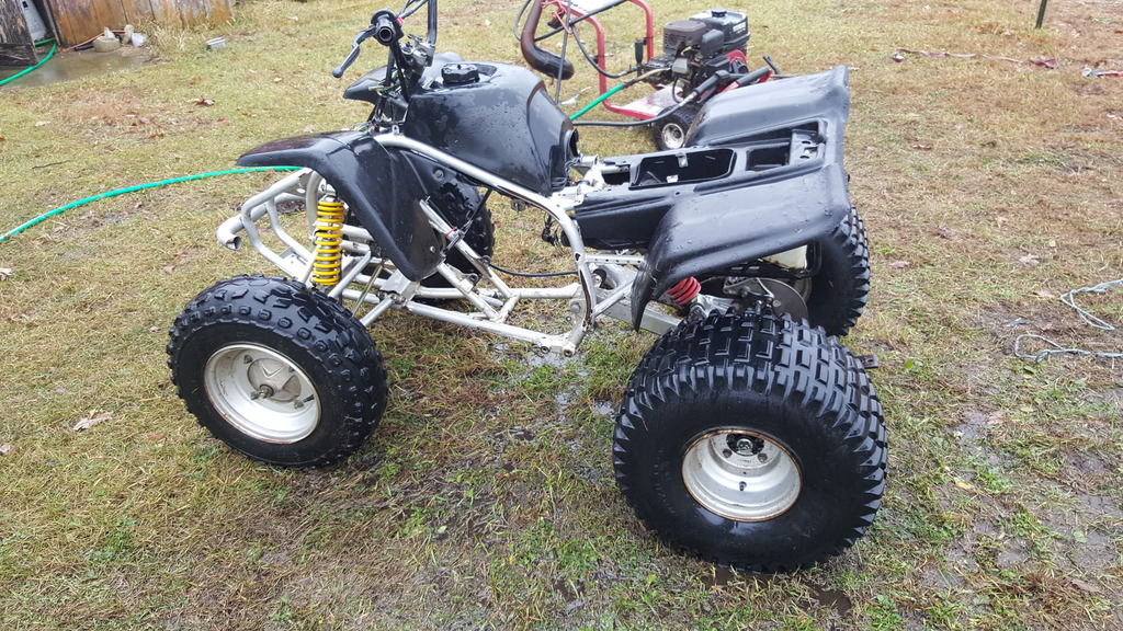

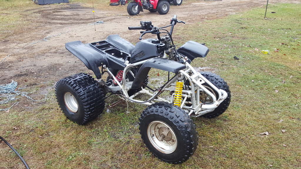

Power washed it off and it cleaned up very nicely

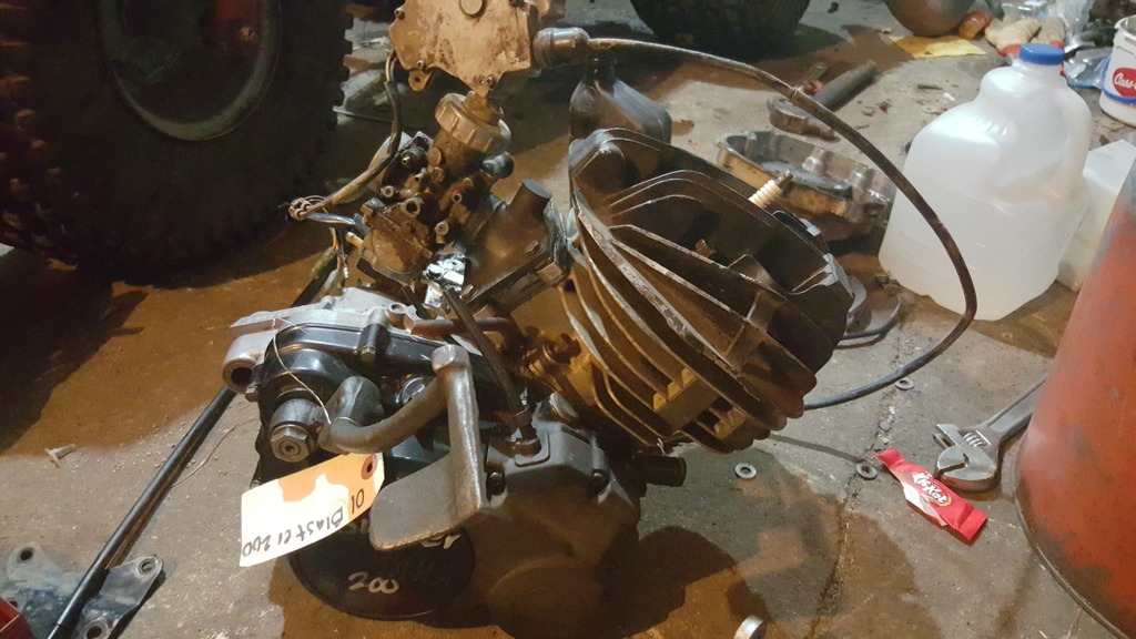

Picked up a 2001 motor, foot peg and clutch cable today

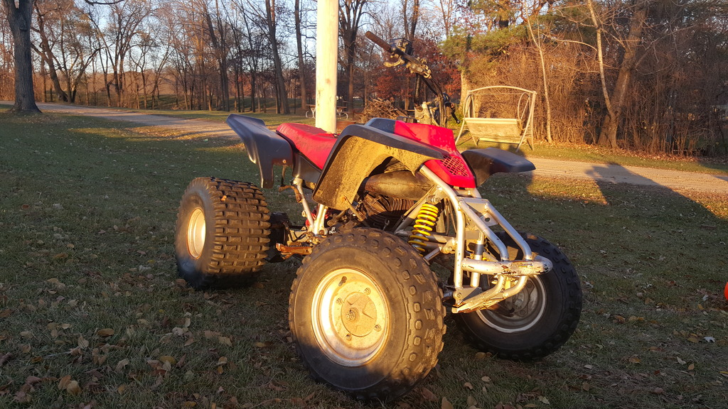

new plastic nose too
All i need to do is put a helicoil in one head stud hole, and pick up some hardware to mount the foot pegs and motor. Then i have to locate a stinger for the exhaust. I found a nice red seat with no rips for 50$ too so I'll pick that up once I have the money.

the Honda runs great but the starters bad, so once i get the blaster together I'll work on that. But i did get the motor in the blaster, that was interesting to do alone.

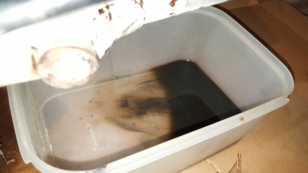

I tore into the motor to see why the kick start spring wasn't engaging and i found out why.
And what little bit of gear lube that came out of the drain plug looks like this
I didn't find the little broken off piece of spring anywhere under the cover, so what are the chances of it ending up falling into this hole?
Grrr. Just my luck. I'm not sure if someone might've been in here before and removed the broken piece, or if it's floating around in here waiting to ruin everything for me.

Unless the guy you bought it from mentioned taking it out chances are if he was roll starting it or lifting the kicker by hand each time, rather than getting a spring for 5-20 bucks depending on new, used, dis.counted, retail, then he never even bothered to pull the clutch cover and the piece of spring is setting on the bottom of the case somewhere. Its probably lodged under or around a bolt hole with sludge holding it in place, of course regular oil changes will probably free it up so it can unleash I spring steel fury when u least expect it.
Lol, maybe not but similar has happened to me more than once.
Might try to fish it out with a parts magnet , but you would have to figure out if where it was at first, might put an oil plug with a magnetic tip.
It could have already came out with the oil in its own as well, to split the cases or not, it's a crap shoot either way!
If i split the cases, what would I expect? I really don't want to pop it open and have some of the transmission gears fall out on me. And also i talked to the guy who ported that jug, and he said he doesn'tknow what he did exactly. He just went crazy with a dremmel which makes me think another reason why I'm not running is the port timings off. I'm probably just going to get a new top end kit with jug included so i don't have to worry about it. I did also score a reed spacer too

Splitting the cases isn't too bad as far as requiring any special skills, but you will need a flywheel puller, clutch/flywheel holder, case splitter (similar to a steering wheel puller), torch, 1104 case bond (Permatex moto1),2 a service manual, the knowledge and parts mentioned in KORS, Blaster teardown and assembly vids.
I would go ahead and replace at least the main bearings and seals, and possibly have the crank rebuilt with a new big end bearing.
The good news is while the engine is apart you will have a chance to check/replace all the bearings (counter weight /trans), as well as do the shift star mod which makes for smoother easier shifts, and verify that everything is good in the bottom.
Really you should go ahead and split the cases, if after watching the vids you feel comfortable with it. If you don't, you will probably regret it, about the time you get the top end done and have to worry if the bottom will hold up.
