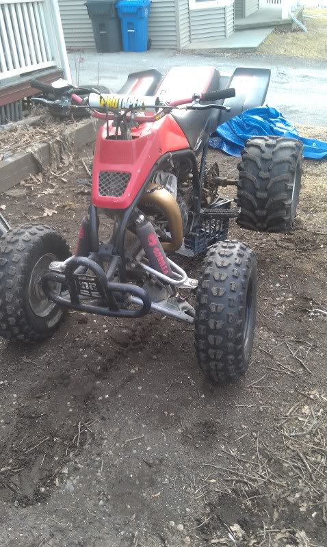

Hey everyone. My name is Tim. I havent had an off road toy since i was about 9 years old with a little pw80.
I have had street bikes and love to tinker with my car but picked up a blaster for something new to play with.
I got it in trade for a streetbike project that i was working on ang lost interest in.
I am told it has a vito's 240 kit and got an extra piston with rings as well as extra spark plugs and various jets for the carb.
When i got it the P/O had broken the clutch lever and snapped the cable.
So i promptly ordered new parts which came in today. A few minutes of work and i wass ripping up the backyard with it.
I have gone in excess of 170mph on a street buke but i will say that this thing might actually be more fun.
I was intending to repair it and sell it but i decided i will keep it for a while.
Anyway here are a few shots of it.
If anyone woould like to give me a hand with some info that would be great.

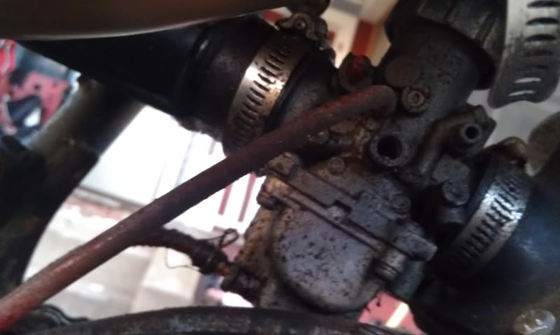

also i am now entirely familiar with carbs but there are two vaccum hoses on there that are just ran down under the bike and are open.
im not sure where they should have gone. Heres a pic:

the 2 lines hanging from either sides of your carb are vent lines, and must be kept open, should be one more from the lower back of the carb bowl, thats the overflow

Is that the stock carb? Wow! If it is, get rid of it and get a 35mm carb. Upgrade that pipe and get that 240 ported if its not. Huge power gain with what I said.

welcome to the forum! you're gonna have the mod bug REALLY bad pretty soon....looks like you've got a pretty good start on it
Is that pipe for sale on ebay now? I seen a gold painted pipe.
i missed your post completely. it is not my pipe on ebay. i am keeping this pipe for now. gold was the only high heat paint i had at my house at the time.
I have the mod bug for anything i own. I dont think i have ever owned a vehicle or toy that wasnt modded. Even my little beater civic has an acura motor shoved in there.
