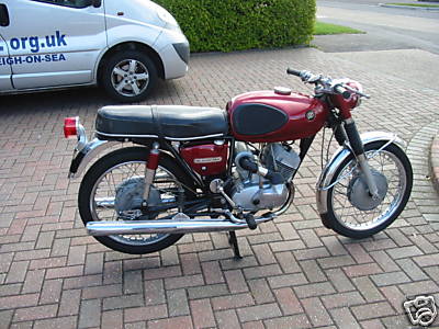

The day I picked it up. Hey for a hundred bucks, you can't expect too much but it's got a good title and it rolls. lol.
This is what they originally looked like. Spitting image huh? :o
My only issue with the whole project is that the exhaust comes out of the jug directly into the downtube. I'm just going to hack out part of the downtube and weld in a beefy section of 2" DOM tubing I have leftover from a rollcage that the exhaust will run through. Then the stock exhaust will get hacked up for the time being to fit. Then if anyone knows of any shops that build custom expansion chambers or any specs I could go off of to build one from it'd be cool too.

wow good deal... yours and the next picture look exactly alike!!! ( sarcasm) i would be carefull with hacking up the exhaust because...that is the make or break point of these kinds of projects. try to get it running without damaging the exhaust too badly.
