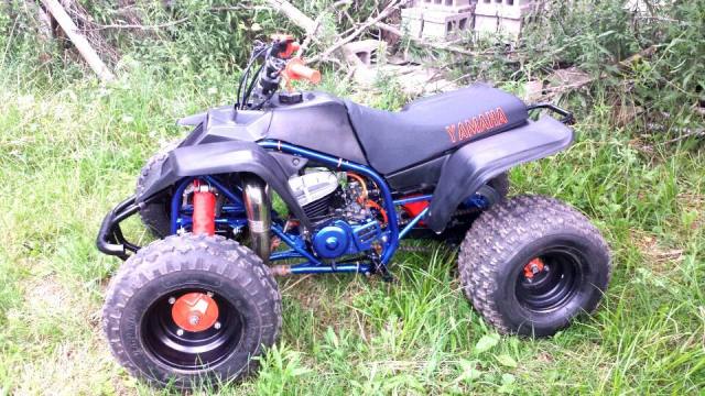

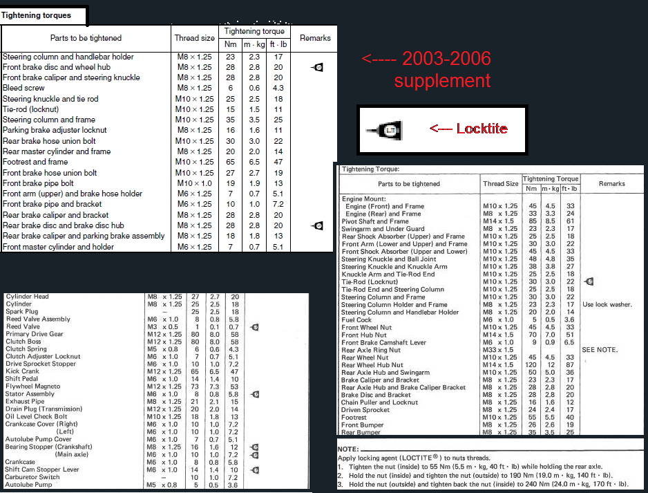

Hello, I'm Matt from Indiana. I came across this forum last year while looking for parts for my 88 Blaster and have been lurking here since. I acquired my blaster from my Grandpa who was tired of spending money on it. The Blaster sat for over 8 years, so I decided to rebuild the top end and carburetor. I also tore the bike completely apart and re-painted the frame, wheels, bumper, engine, axle carrier and powdercoated the A-arms and swingarm. So far the only mods I have are a Pro Circuit exhaust, cheap lowering kit (I don't jump the bike anyway), and flipped wheels. I look forward to getting to know some of you and gathering really good info about our Blasters.
Sorry about the junky smartphone picture, I took it last summer.
